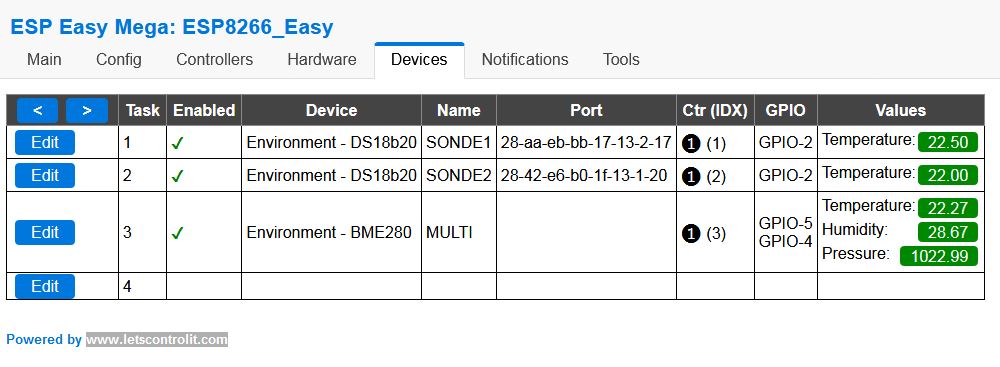

Hello all ESP-Easy users, I'd like to know if they are special requirements to setup Data xfert from ESPEasy to Domoticz ?
My configuration is : PC under Win7, ESP8266 with DS18b20 and BME280 devices under ESPEasy Mega V2.0.0. You can see on snap I get measurements from devices.

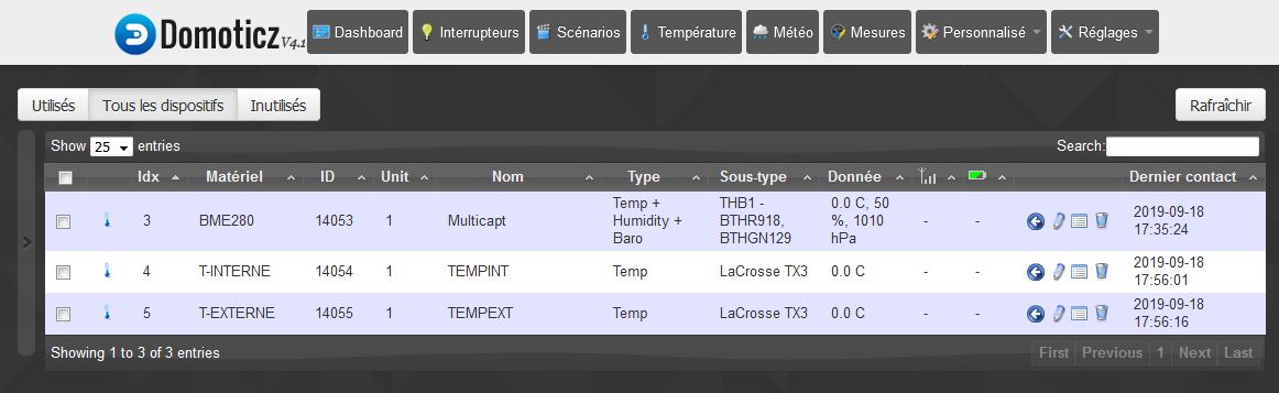

On Domoticz devices with Idx configured : Unfortunately no data received from EASYESP : Any ideas are Welcome !!!

IDX is 3 4 5 in the screenshot from Domoticz. So you need to change the IDX to match.

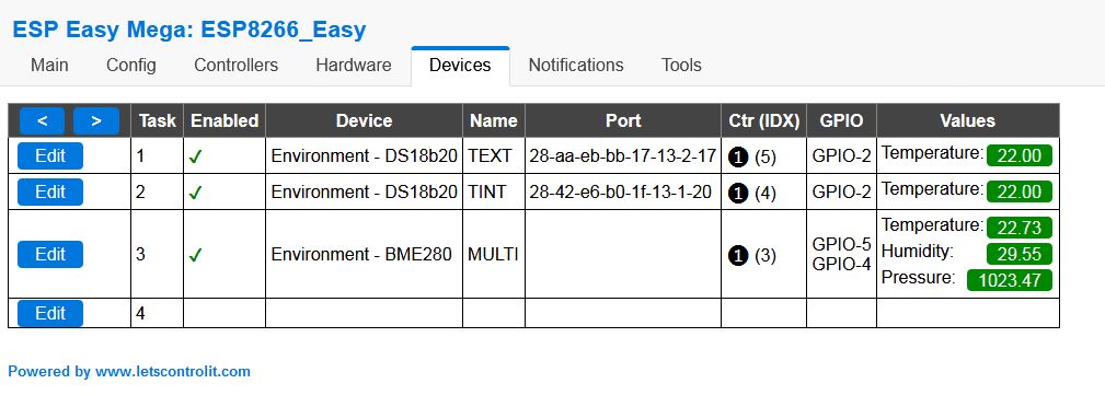

Thanks grovkillen, I've modified to :
then
No changes .... Unfortunately.

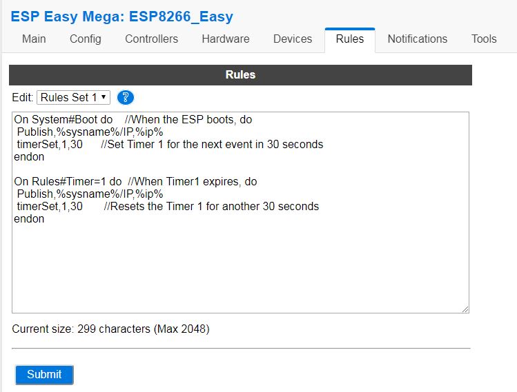

So where to place this ? (nothing in Devices to add Topic, Value) then on Tools as Command ?
Ok after search now new Page on ESPEasy :
Any idea how to recover (in this example) under Win7 cmd prompt data send by ESP on MQTT ?

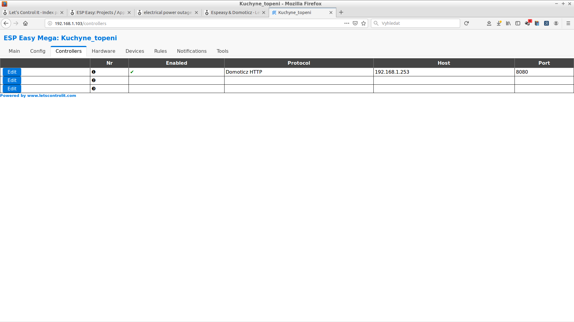

Use Domoticz with http.
Works perfectly with a large number of sensors too.
( cca 160 sensors in my case )
Both types - sending to Domoticz and receiving from it.
