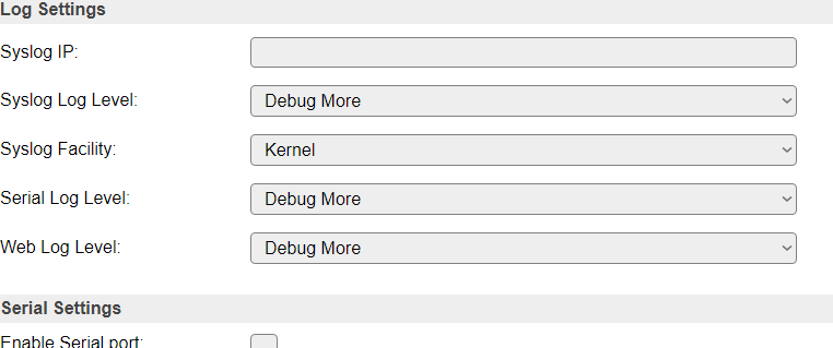

#17 Post by TD-er » 25 Oct 2019, 13:39
I guess so.
Only thing is if you are sending them to ThingSpeak, you may run into another issue.
It is a known issue that Thingspeak does require the http request to wait for a reply.
The sendtohttp command does not wait for a reply, so that may also be the reason it can fail to send data to Thingspeak.
What I did change is to remove any trailing spaces in the path.
You could also wrap the path parameter in quotes just to be sure no other strange characters are present.
Maybe also change the whitespace between the command and the IP address into a comma, just to make sure there is no tab present.
SendToHTTP,34.226.171.107,80,"/update?api_key=SUPERTOPSECRET&field4=1"
Quotes wrapping a parameter should be removed from the parameter if they are the first and last character (after removing trailing spaces)
So you should see in the (debug) log that the quotes are removed. If they are still present, it means there is something else added.

#18 Post by EDsteve » 25 Oct 2019, 14:21
I tried quotes and also added a command for Domoticz:
SendToHTTP,192.168.8.167,8080,"/json.htm?type=command&param=switchlight&idx=27&switchcmd=On"
SendToHTTP,34.226.171.107,80,"/update?api_key=SECRET&field4=1"
But no success. I could go crazy :o
But the quotes are still in the debug log:
1753696 : ACT  : SendToHTTP,192.168.8.167,8080,"/json.htm?type=command&param=switchlight&idx=27&switchcmd=On"
1753706 : Command: sendtohttp
1753707 : SendToHTTP: Host: 192.168.8.167 port: 8080
1753737 : ACT  : SendToHTTP,34.226.171.107,80,"/update?api_key=SECRET&field4=1"

EDsteve
Posts: 61
Joined: 11 May 2018, 21:13
Re: Weird interpretation of the &-Symbols in Rules / SendToHTTP not working
#22 Post by EDsteve » 25 Oct 2019, 18:10
I tried that already since yesterday, but whatever i do. The Debug-level never changes. These are my settings:
And this is how my Log looks like:

Well, "debug more" is a bit too much logging.
Are you sure you're running last night's test build?
I don't see the log output describing the parsed parameters of the sendtohttp, but it can be the logging was just flooding all buffers and some log lines got lost.
I will have a new test build in about an hour, which does have some other fixes too, although I doubt those other fixes will be related to this issue you're having.
But maybe best to test the newer build, since we're then sure it has at least all the commits in it I meant to have in it last night. (build started past 3 am, so not sure how clear my head was by then)
