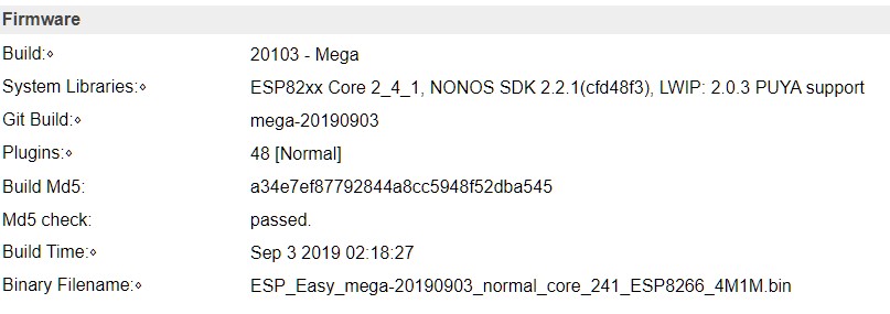

Hello everyone.
I have been playing with the ESPEasy firmware for some time. Mainly with various ESP32 modules. I am very satisfied with it. Today I bought a new ESP8266 NodeMCU. Unfortunately I didn't get it flashed with the ESPTOOL. No problem with the Arduino IDE.
But now my actual question. I would like to use my Nextion Enhanced 7 "display. Unfortunately I can no longer find it on the" Devices"tab :(. Because I have now used the Arduino for the first time to flash, I have used of this link: https://www.letscontrolit.com/wiki/inde ... are_Upload
This is probably an older version, because I can't find the following lines anywhere:
// build all the normally stable plugins
// # define PLUGIN_BUILD_NORMAL
// build all plugins that are in test stage
// # define PLUGIN_BUILD_TESTING
// build all plugins that are still being developed and are broken or incomplete
// # define PLUGIN_BUILD_DEV
Is there an option to still be able to use the Nextion Display?
Thanks in advance!
Here a screenshot of my Firmware settings.. Just in case... lol
Firmare settings.jpg (45.92 KiB) Viewed 21913 times

As far as I know, it is included in the "test" build.
But the problem is that lately the build size of the pre-built binaries has become quite large.
The nightly builds have a check to see if a binary will fit and if not, it will not include them into the zip file.
So it is very well possible the last build(s) do not have all binary versions included in the zip file.

You should try "test" instead of "normal".

grovkillen wrote: 15 Nov 2019, 09:20 You should try "test" instead of "normal".
Oh thank you!
Now I get the "Display - Nextion"
The testing can go on.
