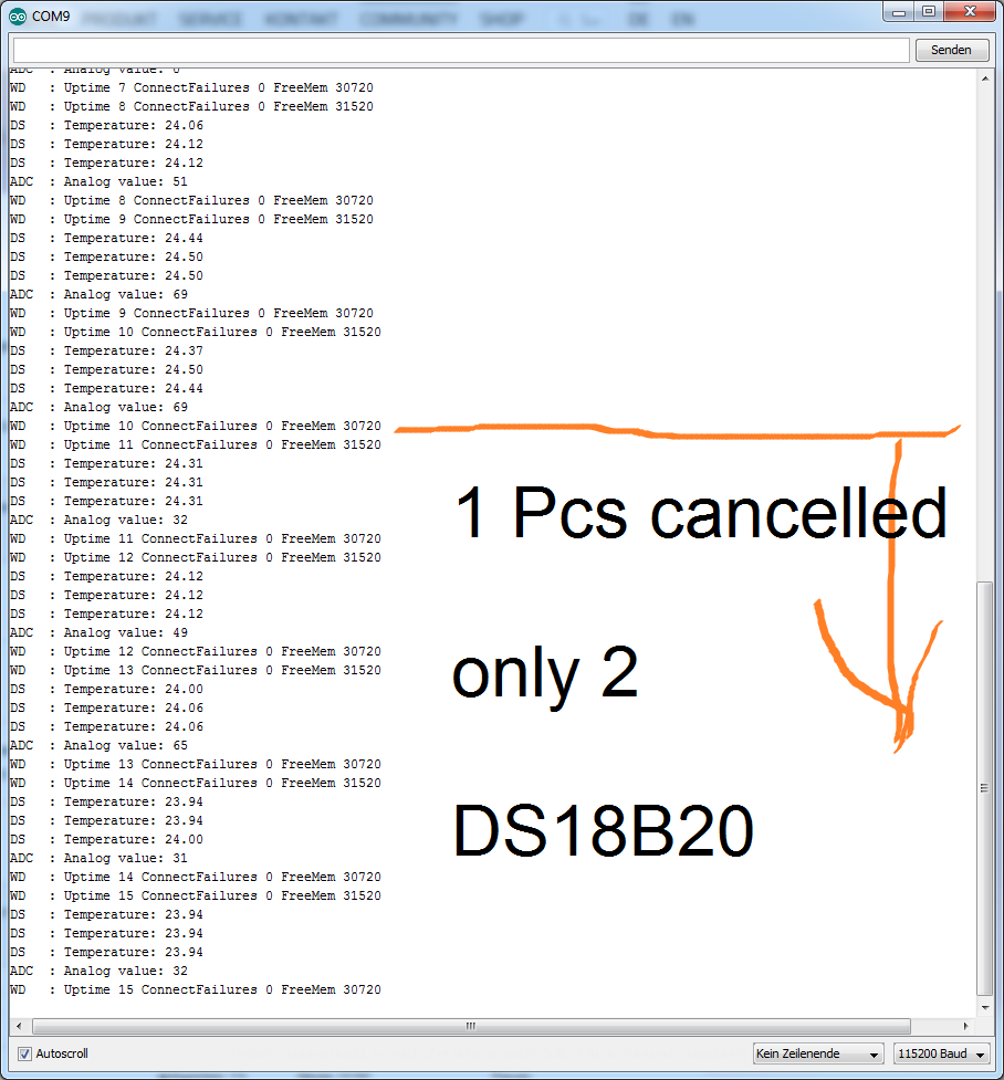

#6 Post by BerndJ » 06 Oct 2015, 16:15
I thing we had a problem regarding the values of the different sensors and the sending to their corresponding parameters. It´s look like a ESP with
dementia.
Attached are one file of the output. At first 3 Sensors are online, i put one away and hoped that these sensor got none value.
These problem i also find at one PCF8591. Fixed values on 4 Ports and hopping values received.
Hope u got a solution.

#7 Post by BerndJ » 07 Oct 2015, 15:28
last night same problems.
I found only two devices on the 1-Wire Bus. cable problems at one sensor are the problem.
the ESP device sends 3 values!!, one are doubled.
After solving the cable problem we had problems regarding the third one. The 3 was on position 2 and old position 2 i could see on position 3.
I think we had to pair the IDx and the device nr with the ROM ID and to store these paired values in the settings.
Also should bee added a routine to send value 0 if one stored ROM ID could´nt find.

#8 Post by Martinus » 07 Oct 2015, 19:17
BerndJ wrote:...I think we had to pair the IDx and the device nr with the ROM ID and to store these paired values in the settings.
BerndJ
It already works like that. IDX and the 8 byte ROM Address are stored in the task settings. So there must be something else wrong with the logics...
Up until now, we had to focus on a lot of other things, but now we have time to do some more testing with multiple DS18b20 on a single wire.
BerndJ wrote:...Also should bee added a routine to send value 0 if one stored ROM ID could´nt find.
I agree. This is also true for other plugins. When we started, focus was on 'getting things to work' and not on "what to do if it suddenly fails".
We will spend some time on making the code more resilient to errors.

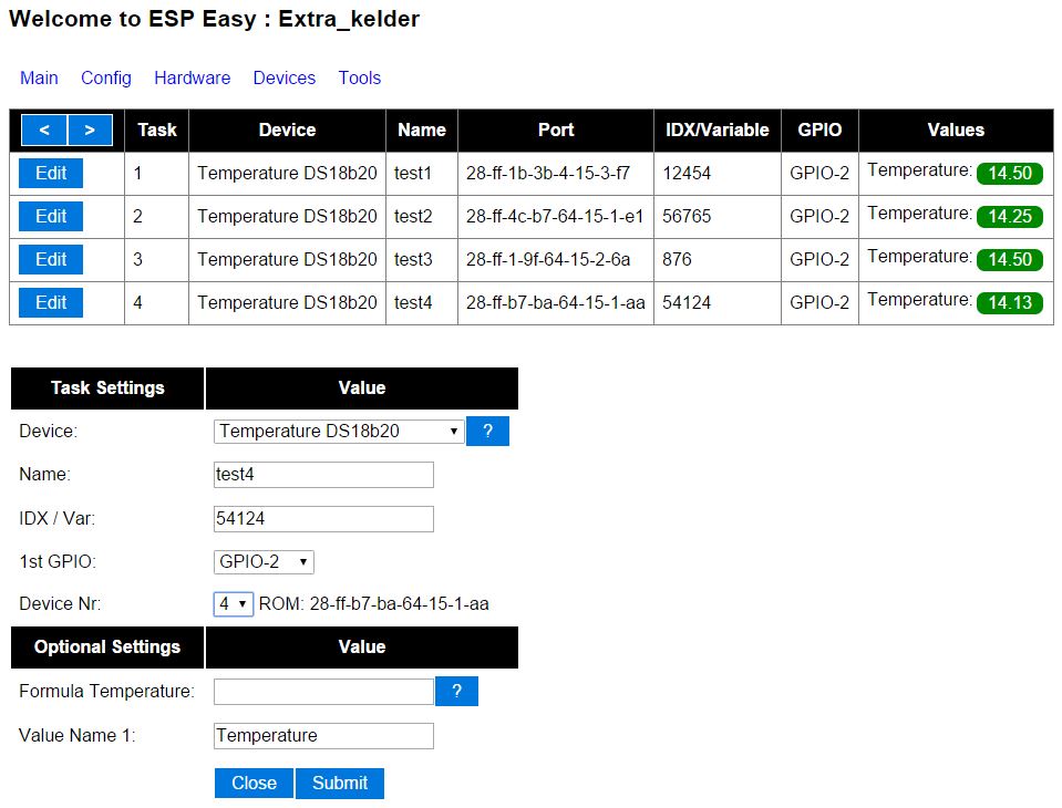

#11 Post by Backbone » 21 Nov 2015, 17:52
Testing:
4 on a string, cable length 1 m, Pull up 4k7 on each DS18B20

#12 Post by kr0815 » 21 Nov 2015, 19:59
You shouldn´t have a pull-up on each sensor, only one in the whole System.
It still works for you, but your total pull-up is now about 1.2 KOhm

Re: More than on DS18b20 on a string.
#13 Post by Backbone » 21 Nov 2015, 20:56
I know about the Pull up is now much lower.
This was just a quick test and the DS18b20 units I had for test where all already equipped with a resistor.
