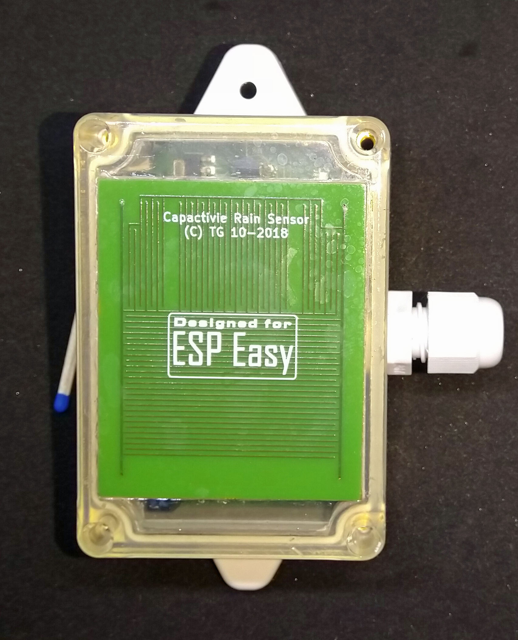

The usual cheap rain sensors from AliExpress and other platforms have some disadvantages.
They work by conductance so the electrodes must have direct contact to the water.
Dirt and aging can influece this, the water conductance may differ depending on
what a raindrop collected on it's way through the air.
Worse, these sensors mostly use DC. Over time the sensor gets corroded by electrolysis.
This design uses a capacitive sensor. It is covered by solder resist, on top I sprayed a thin
urethane film for better environment resistance.
The complete sensor fits into a box of 83x58x33mm soit's about half size compared to usual sensors.
The sensor itself is built around an ATtiny 2313 CPU as it needs more speed then ESP8266 and ESPEasy can deliver.
It measures the capacitance of the sensor by measuring the loading time of the sensors capacitance.
Capacitance varies due to the dielectric constant of the isolation. The sensor board itself has a
dielectric constant of around 4, pure water is around 80 so water on the sensor makes the
capacitance bigger, it takes longer do load it. This difference is measured.
The ATTiny gives three signals for "a bit", "rainy" and "really wet".
The signals are connected to switch inputs of the ESP-07S, LEDs on the PCB show the signal states.
Internally the ATTiny uses a "Meridian" calculation to keep the measurement stable.
Threshholds can be changed in the source of ATTiny firmware.
On top there is a DS18B20 in the box. As it gets warm in the box it is not suitable to
gather environment temperature. It is used to switch the sensor heating on if temperature
gets under a certain level to avoid water freezing on the sensor or snow settling on the surface.
The sensor is heated if it gets wet or temperature is low.
If anyone wants firmware and/or PCBs message me.
(PCB's, ATTiny firmware and schematic designed by me)

It is a nice idea.
Only thing I see which strikes me as odd, is that it has the "cover" over the edge of the sensor at the bottom.
This will keep some water in it and that will break during winter.
ShardanX sent me such a sensor which is basically a PCB with solder mask covering the entire "collecting" surface of the PCB.
So far it is working just great.

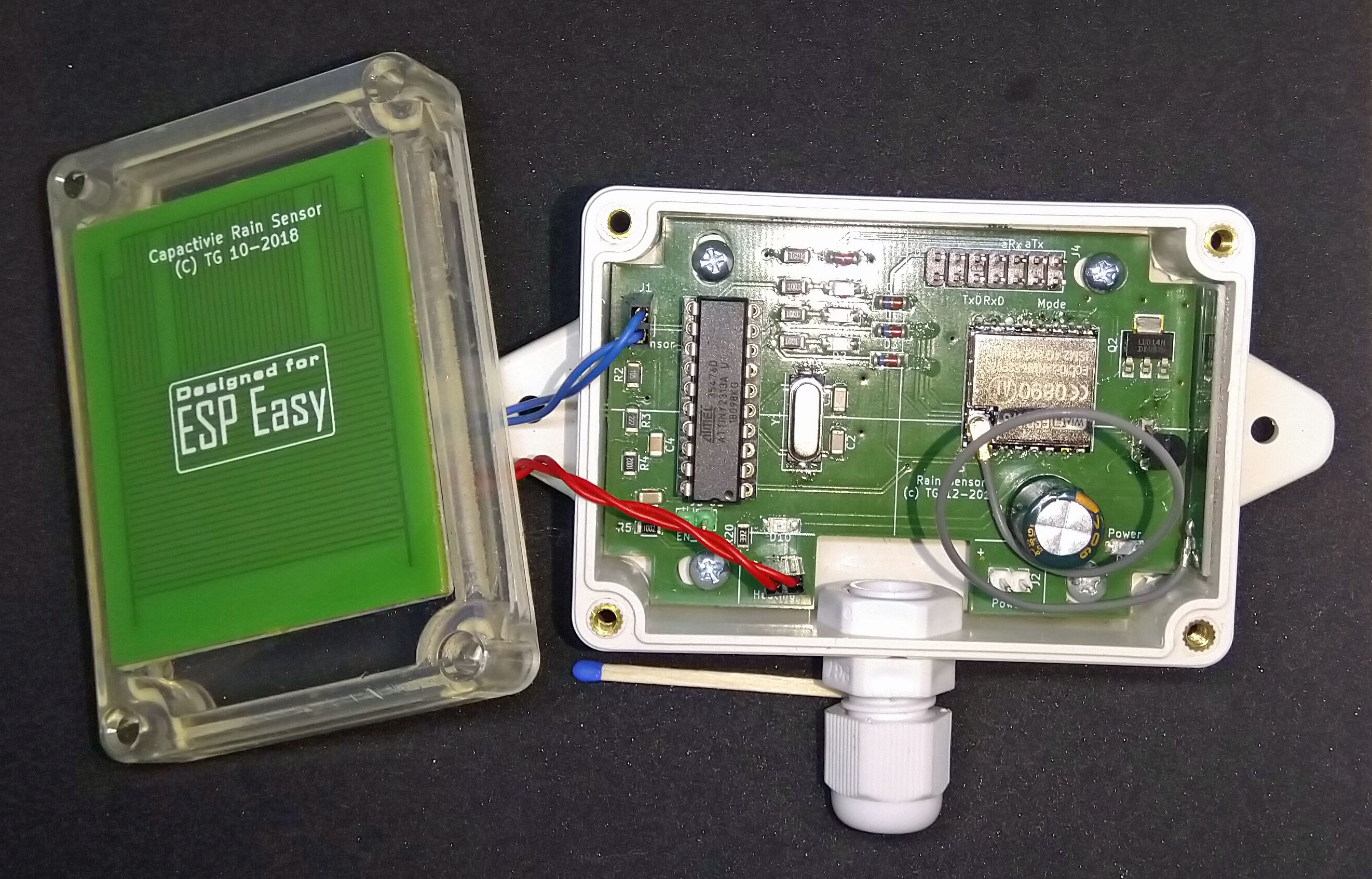

Hello martinus,
for this type of rain sensor a separate MCU is definitely necessary.
The capacitive sensor works quite simple.
The sensor board builds a capacitor. As water has a far higher dielectric constanc then air (about 80 times..)
the capacitance rises when water drops on the sensor surface.
The MCU connects a GPIO to the sensor via a resistor.
First step: The GPIO is set to 0 volt discharging the sensor capacitance.
Then it is set to 1 loading the capacitance and a counter is started.
If a specific voltage level at the sensor is reached, a comparator stops the counter.
The counter usually gives a value around 50--60 if sensor is dry and about 250 if it is completely wet.
The rest is just calculating, building a meridian value of 15 values, setting threshholds for foggy/rainy/wet etc.
Implementing this into an ESP8266 is possible, but it is a problem with the ESPeasy framework.
Counting must run very fast so a plugin would block all other tasks while running, it needs an interrupt and
a lot of variables taking up RAM.
So I think a separate MCU is the better way for such applications.

Using the ATtiny 2313... well, this might be possible on smaller ATTiny chips for sure.
The ATtiny 2313 is my universal workinghorse for small applications, I've always some in my shelf.
For more complex things I use ATmega168 or 328.
Another reason for the 2313: I need some more GPIO then an ATtiny85 offers.
Meanwhile I've changed the firmware a bit. Setting the threshhold values can be done now via
the usual programmer you use for flashing the ESP8266.
Shorting a jumper starts the programming mode, then you can send the value(s) via hterm or
a similiar terminal program. The LEDs show the programming state.
