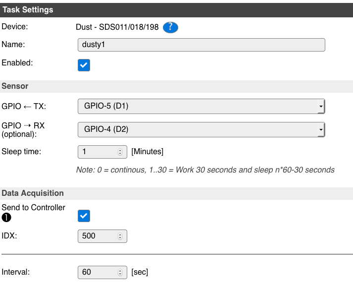

There's definitely a problem with the sleep timer and sending data to controller..
I set sleep time to 2 minutes (2*60s)-30s. I set the data acquisition interval to 120 seconds to correspond.. The data is grabbed from the device at the moment the fan powers up.. not after the 30s work time.
When I choose a different simpler sleep time of 1 minute and interval of 60 seconds.. The data is grabbed from the device after the 30s fan run time.. however the HTTP action to post the data happens before the data is updated from the device, meaning a different kind of inaccuracy.
I've attached the 1 minute typical settings.
What are the correct settings for the following to occur..
Sleep SDS011 for 90 seconds, work for 30 seconds, get data from device, send to controller, sleep SDS011 for 90 seconds etc..
How can rules work as a temporary workaround?

- Screen Shot 2018-07-24 at 10.36.15.png (56.64 KiB) Viewed 12662 times
Re: sds011 problem with sleep timer
It isn't (yet) perfect, I know.
The 30 second run time is just a constant value we cannot change (for now). So you're actually setting the measurement interval and sleep-time at once.
For example when you set it to "5", this means every 5 minutes it will wake and run for 30 seconds and start to sleep again.
You have to make sure the "Interval" timer is at a shorter interval.
Every "Interval" number of seconds, the plugin is called to do some reading and it will collect the data from the serial buffer.
Note that for reading to the SDS011, you only need a read pin. The write pin to the SDS011 is only needed to change the wake/sleep interval on the SDS011.
In the future I may want to change the means of handling wake/sleep to a more "measurement on demand". Now the timing is handled on the sensor itself.
When you set the "Interval" timer too high, then it will try to read a measurement while a new one has just started. This may lead to corrupt data and thus no output.
When the "interval" timer is set too low, you just do more queries for data than needed. But it will only update the measurement when new (valid) sample data is received.
So setting it too low, may just waste resources. Setting too high may give you lots of invalid samples and thus no output at all.
When a valid output is read, it will be available for other processes like rules, but it is almost impossible to sync the ESP time and the sensor time, since they are operating on their own.
Thus keep in mind:
- Interval should be lower than measurement interval
- Interval shorter than 30 seconds is of no use when using the sleep mode of the sensor.
- Short interval timer may only be useful when performing continuous measurements.

I am not seeing the "Sensor - Sleep time" field as seen in the picture above in the firmware I have tried.

Do you have the TX pin defined?

I did, but I think I missed the step of "Submit", so it didn't commit the change and show the "Sleep Time"
