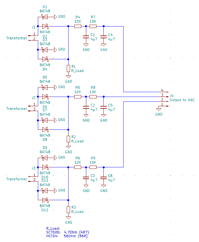

I've created a circuit for this.
Warning! This is not tested and might need further tweaking!
Rectifier Circuit.jpg (188.17 KiB) Viewed 42277 times

However, I will test your schematic, 10Kohm resistors, BAT diodes and 4.7uF capacitors, I already have only thought about using my loops, I will only remove resistors from them because it is possible. what should I mount a resistor on Load ??

#13 Post by Shardan » 13 Jan 2020, 13:25
I'd suggest to re-use the removed resistors or new resistors with same value.
Every sensor coil has it's specific value for the burden resistor (or load resistor, same),
so using the original manufacturer value seems best idea to me.

the system is built and is very good compared to what I had to fight with the selection of R load. My one loop up to 100A has 105 ohm and the other and the other loop up to 30A has 33 ohm. When I connected this 100A and connected the 5W led bulb, I have indication 3-4 and when I connected the 100W bulb, the indication is 73, these are indications without calibration. How to power a multiplexer with 3 or 5V? The readings do not jump and swim ;-)

Load resistor I chose at 330 ohm and the indications are quite good ;-) though it combines if anyone would make this circuit with an amplifier.
