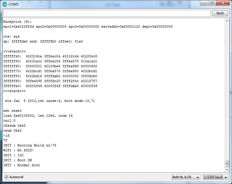

I finally figured out that I needed to switch the TX and RX pins.
Now I get these errors in the Serial Monitor.
Any ideas?

look like you had an exeption, but than it is running normal.
now go to the next step:
the wiki has a start-page for this:
http://www.esp8266.nu/index.php/EasySetup
or in short:
type in "settings" (only this word, means only the letter) on top in the command-line of the serial monitor..
check with a smartphone/tablet, if there is a wlan ESP_0 / ESP_1 ?
connect to it with default wifi password "configesp"
there a some threads around here, where people found the same problem and the same help
hope this helps.
