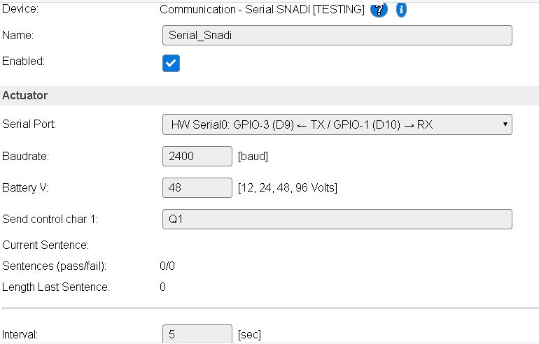

Hi All,
I am modifying the serialProxy plugin to read serial data from battery inverters/UPS systems that support the Megatec serial protocol. It's working but im stuck on one thing. How do i read a value from a text box in the plugin web page and assign it to a variable?
The item im interested in is...........
#define P099_BATTERY_V                PCONFIG_LONG(1)
#define P099_BATTERY_V_LABEL     PCONFIG_LABEL(1)
Complete code below

      addFormNumericBox(F("Battery V"), P099_BATTERY_V_LABEL, P099_BATTERY_V, 12, 96);
      addUnit(F("12, 24, 48, 96 Volts"));

Plugin GUI (Battery V is the item of interest)

#4 Post by rayE » 22 Mar 2020, 03:47
Hi Thomas,
Thanks for that detailed walk through and it did help in my understanding of plugin's. It seems that the example you gave is for the plugin output values, i need the following.
1. The battery V textbox is a user INPUT (one time) that indicates the actual battery voltage the system operates on. This value once entered should be saved to flash and still be present after a cold boot. This seems to be the case as after a cold boot the value first entered is present in the text box.
2. I need to read and use this battery V value in my plugin code and this is the part im stuck with. I assume the value in the text box is stored in the locations defined by
I have tried a few variants of the following to read the value but i get a compiler error stating "event not declared in this scope".
batteryV = getFormItemInt(P099_BATTERY_V);      //Get battery_V from GUI
So my question is how do i read this value?
TIA
Ray

#6 Post by rayE » 23 Mar 2020, 08:54
Got it! Looking at plugin 60 helped, this is the fix.
Declair the variable that i copy the gui BATTERY_V (PCONFIG_LONG(1)) into as a global.
int batteryV;                     //This needs to be global if using in your own functions outside of PLUGIN_READ
Copy the web gui PCONFIG_LONG(1 to my variable in the PLUGIN_READ
 batteryV = PCONFIG_LONG(1);   //Battery_V from GUI    RAE
Thanks again.
