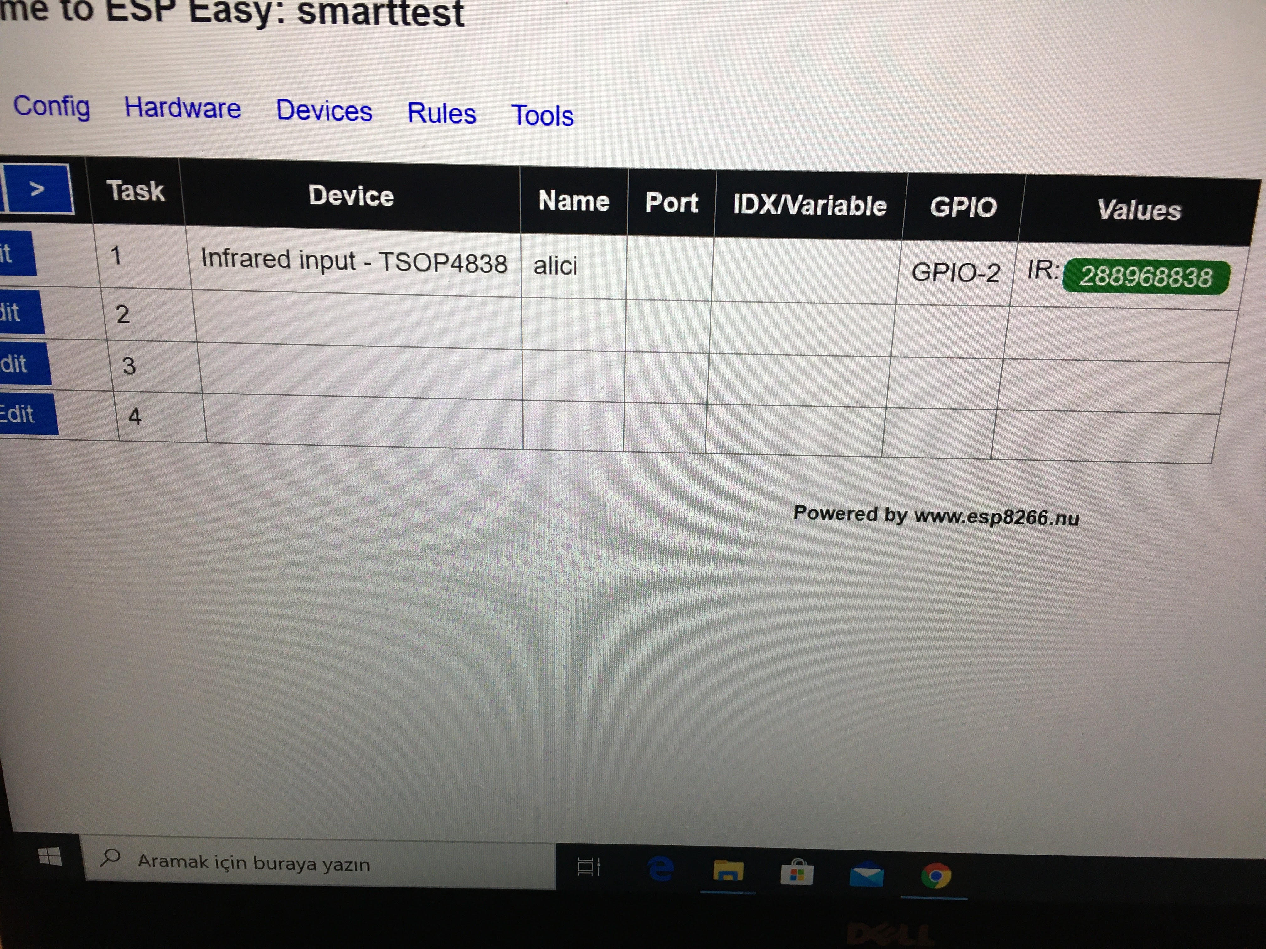

I want to copy my TV remote control code. Esp01 received the code with the IR reciver and the code like 2167155753.

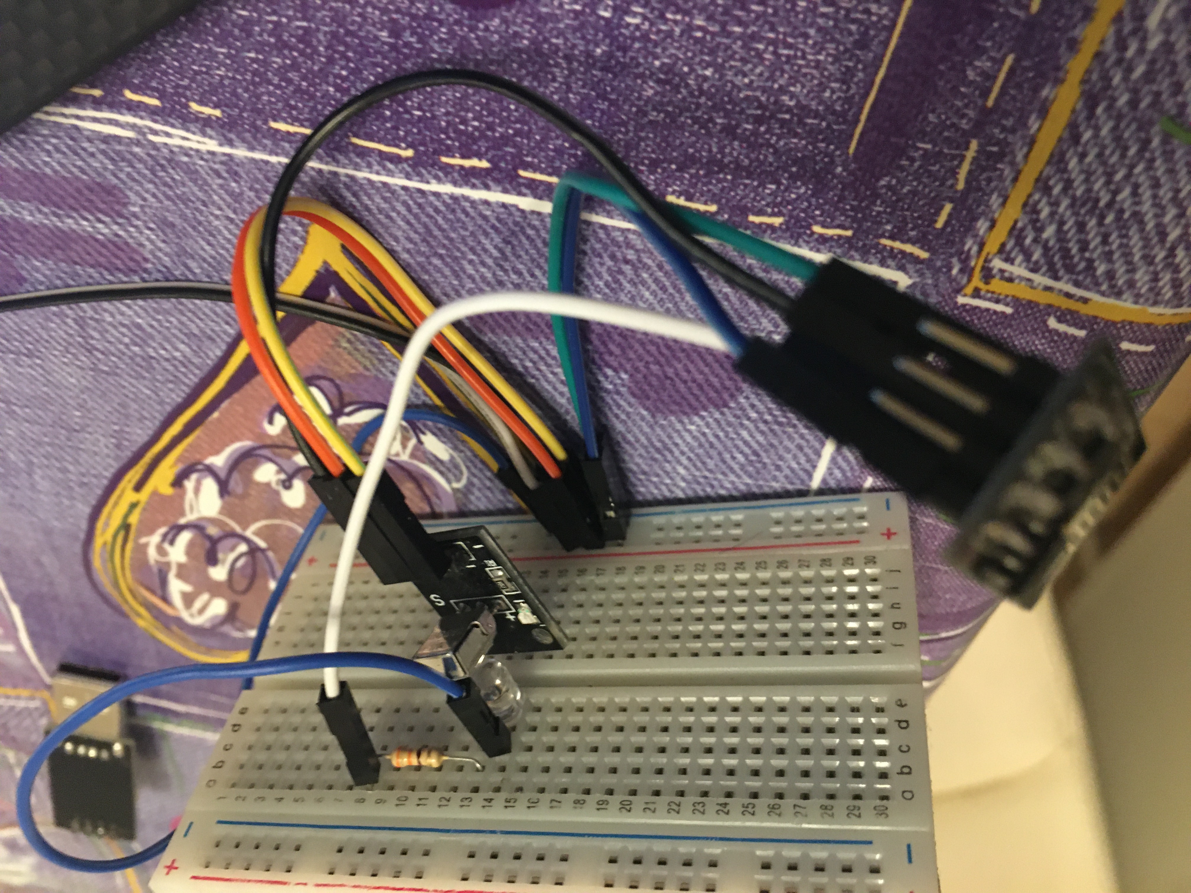

I have attached the pictures

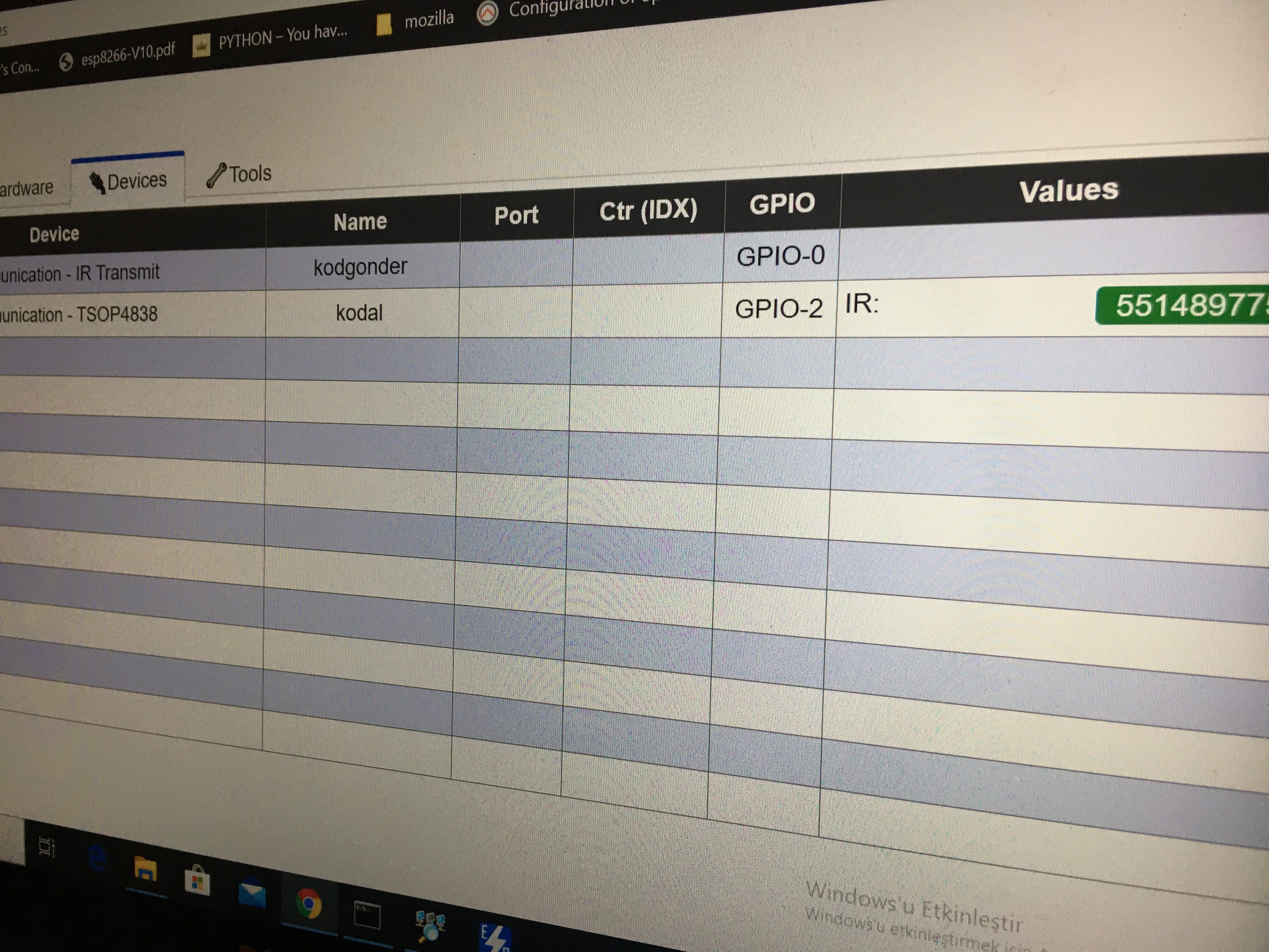

I downloaded and installed the new version of espeasy (ESP_Easy_mega-20200310_minimal_IRext_ESP8266_1M.bin)
Everything seems ok
unfortunatelly, I can receive IR code but I cannot send it.
I received this (551489775) turn off code from TV remote. I want to send same code on tv or IRX receiver but it doesn't work..
I found belowe link that, the code should be 32bit NEC
https://github.com/1technophile/OpenMQT ... de-samples
so I send the command as shown belowe
http://192.168.1.246/control?cmd=IRSEND ... 1489777,32
on tv I couldnot see anything
on IR receiwer; I can only see the light which is on the receiver and in the esp the code don't change.
I am doing a simple mistake I am sure but I cannot solved it. Please help me for this issue.

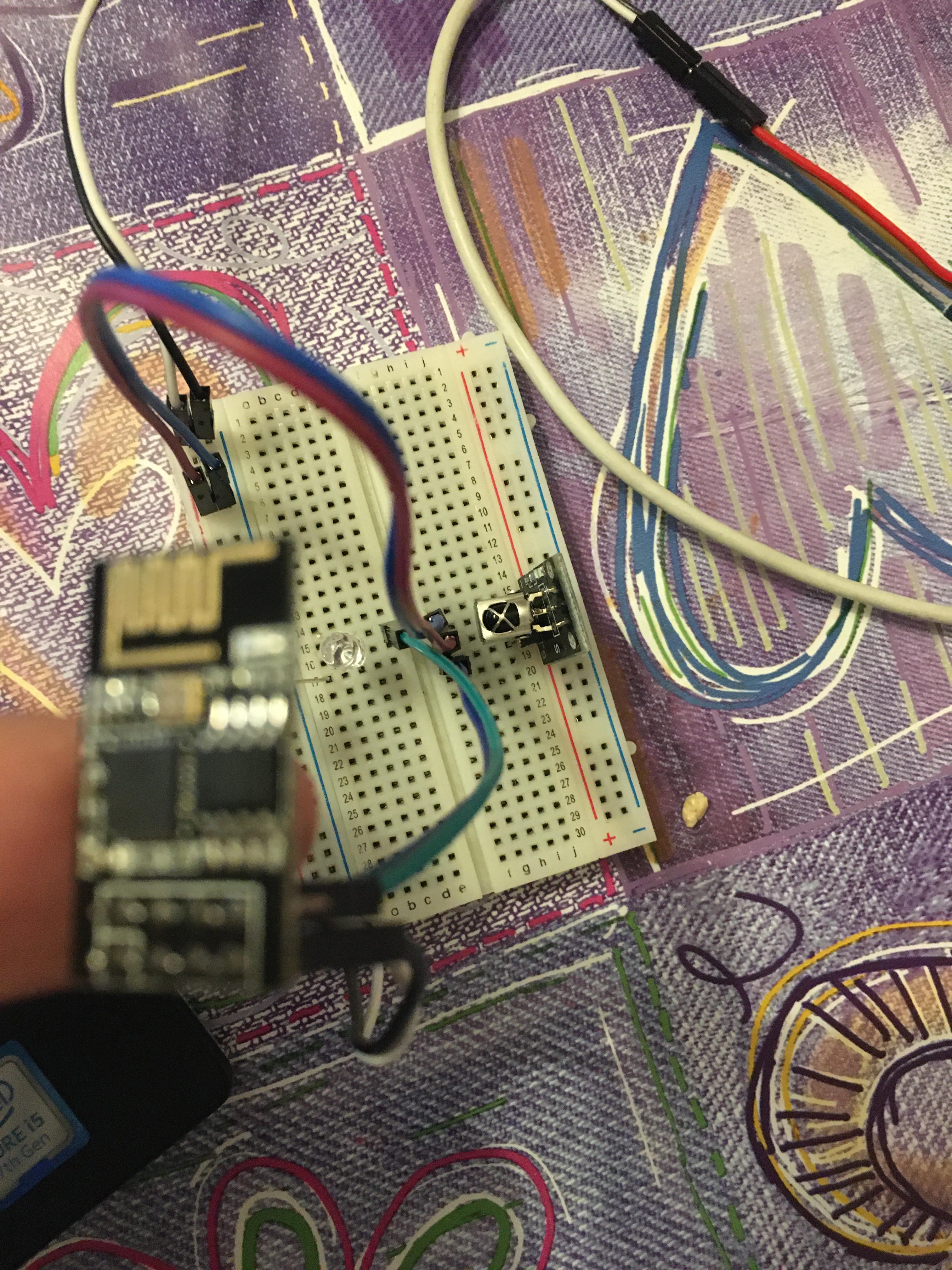

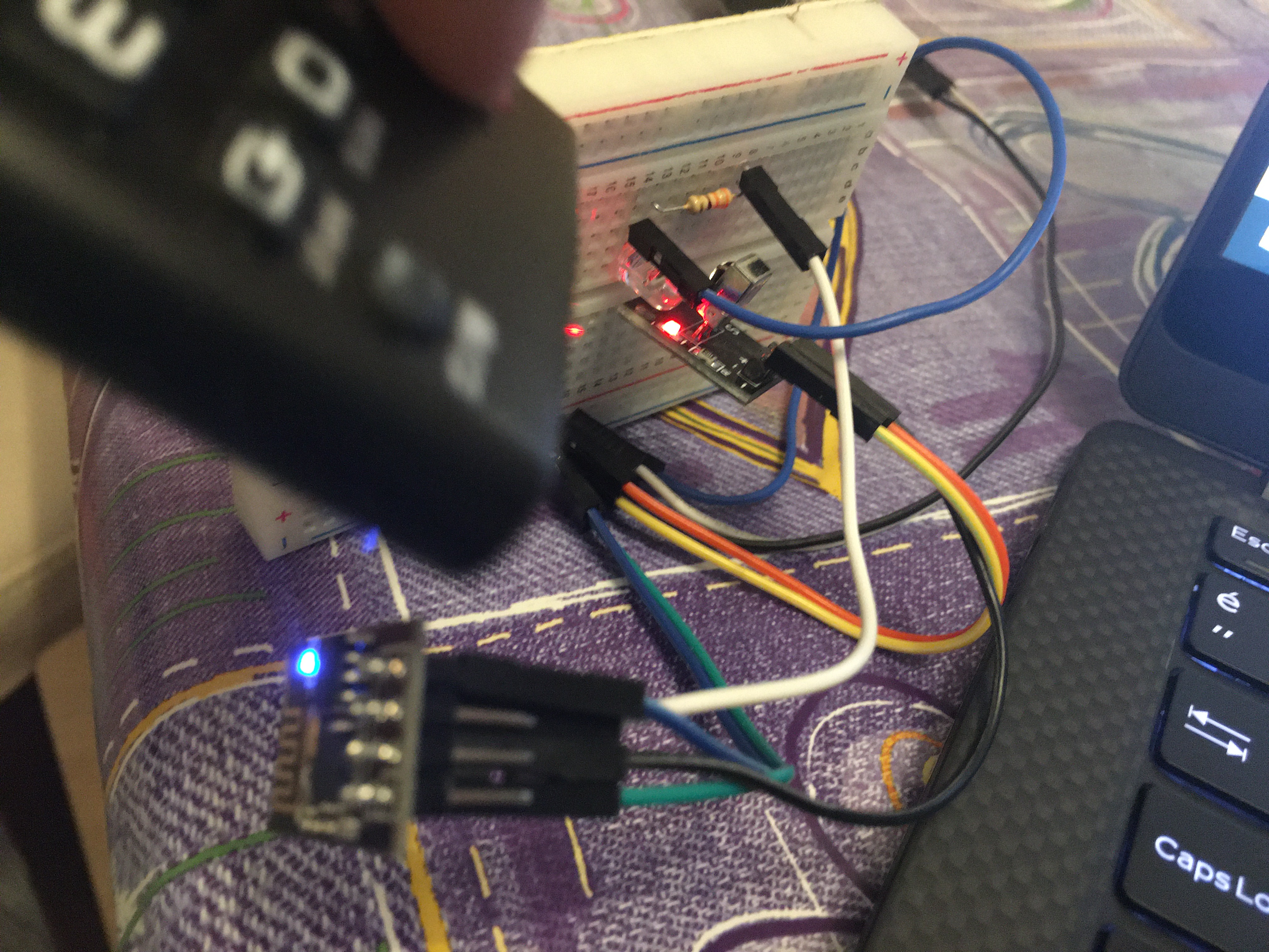

- IMG-0137.JPG (2.29 MiB) Viewed 11793 times
- IMG-0288.JPG (2.59 MiB) Viewed 11793 times
- IMG-0296.JPG (4.11 MiB) Viewed 11793 times
- IMG-0299.JPG (4.53 MiB) Viewed 11793 times
- IMG-0307.JPG (2.49 MiB) Viewed 11793 times

4. Your photo shows that the IR LED is directly driven by the ESP8266 GPIO Pin. Normally a transistor is used to provide sufficient current to drive the LED. Also, when testing the TV's remote operation I suggest placing the IR LED directly on the TV's IR sensor window to ensure a strong/reliable signal.
