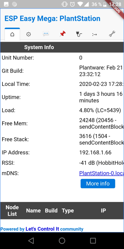

Please take a look at the small application I developed for searching, configuring and bookmarking Espeasy devices.
Application can find Espeasy devices by Wifi AP, mDNS, scanning local network. JSON data is downloaded from device and if the data corresponds to Espeasy, device could be bookmarked.
At this moment the only devices found by scan could be bookmarked, and the STA MAC is unique Id of the device, so each time you bookmark device, the info including it's IP will be replaced. I'm going to change this behavior in the next release.
Link to application in Google Play
Please do not hesitate to open tickets on the App page: https://github.com/iotschmied/IotMage/issues
- Screenshot_2020-02-23-17-28-37_resized.jpg (154.15 KiB) Viewed 89593 times
- Screenshot_2020-02-23-17-26-53_resized.jpg (85.17 KiB) Viewed 89593 times

The rendering of the webpage of ESPEasy is not usable on my phone.
If a page is larger than can be displayed (e.g. controller settings page) then you cannot scroll to the bottom to access the submit button.
Just as if the top of the page is forced to remain visible.
I'm using Motorola One Vision running Android 10.
