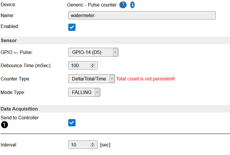

Sometimes I need to do maintenance in my electrical/network setup and I have to reboot the ESPEasy device during the day. I'm running pulse counters and after a reboot the total of the day so far is lost. Luckily I can gather the collected amount of pulses from my mqtt broker logs.
I'm looking for a way to push a Total value to the pulse counter. I tried it with taskvalueset but it doesn't work?
http://192.168.1.173/control?cmd=taskvalueset,1,2,163 (where 163 is the amount of Liters water we used so far during the day).

Hi TD-er,
What is the best way to approach this? So far I have come up with a small script that copies existing value of the pulsemeter to a dummy variable.
on watermeter#Total do
let,1,[watermeter#Total]
TaskValueSet 2,1,[VAR#1]
It takes some time before the dummy variable is updated though. And after a reboot, the value of the dummy plugin is gone. I think I'm overwriting it again with 0 on init. :(
Can someone help me out please?

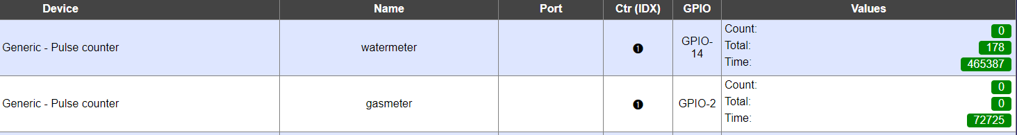

I have a nodemcu v3 running mega-20200328 and it collected pulses from my NPN sensor and reed sensor the whole day for water and gas. I have been using the resetpulsecounter command succesfully every day at 00u00 to reset the counters.
The only thing I didn't try is to reset the device during the day, hoping that it would have saved my already collected pulses.
I just tried it and only task 1 seemed to be stored in memory. Task 2 data was gone after the reboot while it should have already collected 41 pulses from the reed sensor.
Any idea what is going on?

#19 Post by TD-er » 06 Apr 2020, 20:43
The pulse counter does not save the data on every count, so if the task has not been "run" (see taskrun command) and/or the interval is set to 0 or a very long interval, then you will miss all pulses since the last time the task was "run".
bulthaup

#20 Post by bulthaup » 06 Apr 2020, 20:59
TD-er wrote: 06 Apr 2020, 20:43 The pulse counter does not save the data on every count, so if the task has not been "run" (see taskrun command) and/or the interval is set to 0 or a very long interval, then you will miss all pulses since the last time the task was "run".
Hi TD-er,
The interval is set to 10 seconds for both pulse counter so in the 19hrs of uptime after resetting the counter last midnight, I would assume it should have run at least a couple of times already no?
Re: Change Total value of a pulse counter with command
#21 Post by TD-er » 06 Apr 2020, 22:07
Hmm that sounds like an undocumented feature.
Since documenting things is not my favorite, I guess I will try to change the code :)

#35 Post by bulthaup » 10 Apr 2020, 19:23
Hi, thanks for the build. It still doesn't work for me :(
As you can see, the "Time" value for the gasmeter (task 2) got restored somehow??
I'm going to make a new system with a D1 mini to rule out that the nodemcu is bugging me. I'll provide some feedback asap
Before:
After reboot:

I can reproduce the issue with a D1 Mini.
A simple reed sensor (Aleph PS-3150 Proximity Sensor) is connected to GPIO-14 (D5) and the other leg to GND.
Adding it to task1 or task2 doesn't make any difference. Executing the "taskrun, 1" command also does not trigger the values to be stored to survive a warm reboot. I also didn't execute the command and just waited 5 minutes.
