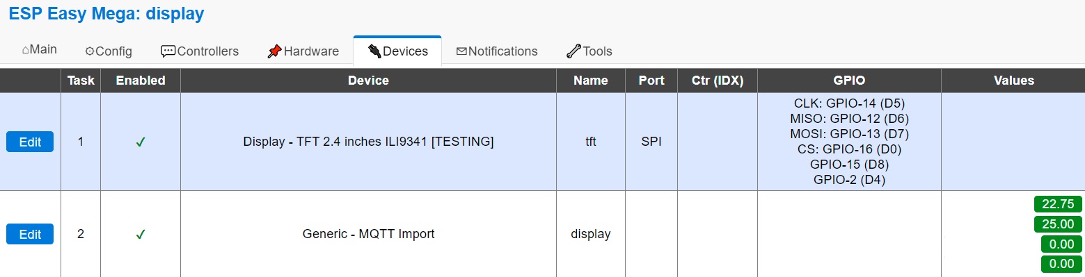

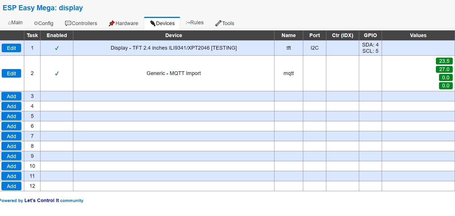

Has anyone tried it and maybe help howto wiring it up to a Vemos d1 mini?

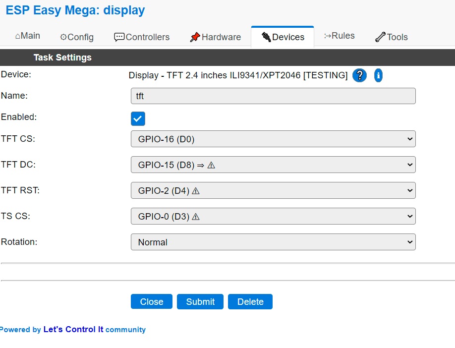

Got it working.
On my other displays I can show data from MQTT easy with sttings in the display menu.
Now it seems like Commands must be use for getting text on display.

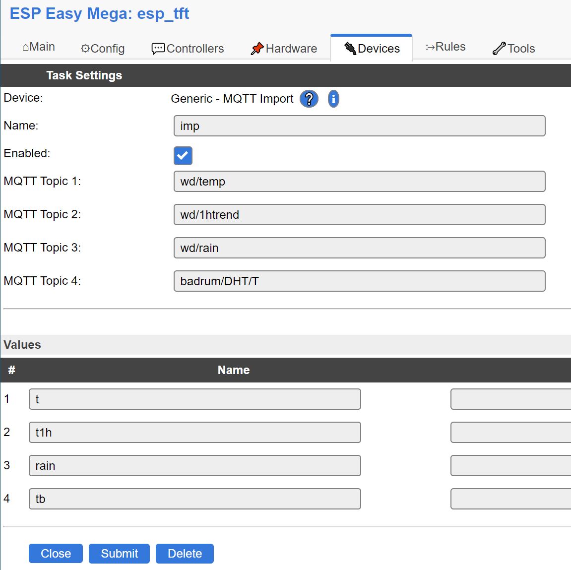

How do I get the display show example temp if I got MQTT imprt setup like this
Got it working.
- mqtt_imp.JPG (118.62 KiB) Viewed 55733 times

ATH thanks for suggestion...
Yes, my mistake. When i checked it again i found eps8266 release with display
But still have white screen without showing readings from mqtt.
In MQTT import temperatures are shown on screen i only got in upper corner ESPEays text...
Connections from wemos d1 mini pro to ili9341 are the same as previus topic:
CLK D5
MISO D6
MOSI D7
CS D0
RST D4
DC D8
Vcc and led backlight are in 3.3V
CLK D5
MISO D6
MOSI D7
CS D0
RST D4
DC D8
Re: ILI9341 seems to work in new firmware
Is SPI enabled in the hardware tab?
Yes
- 2.jpg (112.82 KiB) Viewed 36907 times
- 1.jpg (96.45 KiB) Viewed 36907 times
How are you displaying the data on the display?
I`m first time doing with spi display.
I thought to do it with rules?

I`m still looking for solution for my ili display. I`m getting my mqtt imports datas but from here i don`t know how to show it on display?
What do you currently have in your rules?
Can you get anything to show on your display using commands you can enter via the Tools page?
