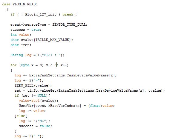

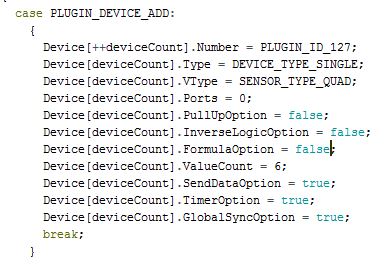

Je teste depuis quelques semaines mon compteur Linky avec le plugin que tu cites sur lequel j'ai fait pas mal de modifications. C'est stable en remontant même les infos toutes les 20s à mon controlleur domoticz.
Je n'ai pas encore fait de pull request et j'hesite à faire un nouveau plugin. Mais je vais essayer de contribuer un peu plus dans ce super projet qu'est EspEasy.
En attendant voila le code si cela peut servir et relancer les échanges:
https://github.com/gmella/ESPEasyPlugin ... leinfo.ino
Attention comme mentionné c'est en mode STANDARD donc a completer pour supporter les deux modes...
Thanks a lot for ESPEasy ! I enjoy and use it more and more.

Giving your mention about I2C adress and Channel, I never saw such things. I updated my ESPEasy package. I pulled the head mega branch this morning and I discovered the points. Many changes occured but I succeeded to read again a counter leaving those field with default values but selecting again HW Serial0. This make the proper GPIO selected in GPIO <-TX field. For that I do also have to disable javascript else I was not able to edit the device seting page properly.
I'm sure that these points will be fixed in the future.

- "send to controler" disabled
Findings :
Connection to the meter, PAPP is updated sometimes once at power up, then no more reading.....it seems ESP8266 is at the edge of speed and memory capability (software crash ?).
When I browse though ESP webpages (my computer connected to ESP though IP adress of ESP), I regularly get the message "Low memory. Cannot display webpage :-("
, and many times there is timeout = no page display.
To go further in analysis of what ESP does,
Is it possible to query the "teleinfo" values using http command to ESPeasy
(for exemple, on Wifiinfo software, It is possible to send the command EspIP:Port/control?cmd=taskvalueset,x,x,%IINST1%)
Guy

I loaded your last revision plugin, and now the frames are correctly received - I checked all the labels in my teleinfo frame :
- all labels with value = number , are correctly received
- labels with value = ascii characters display "0" for example "OPTARIF HC", or "PTEC HP"
The log (tools/log) show same OPTARIF 0 PTEC 0
=> it seems the teleinfo library that we use does not properly store ascii characters in the "value" field
Anyway, thank you for your support - I see the light at the end of the tunnel...
Guy
Are you going to update the plugin to make more than 2 labels/values available ?
gmella

In the mean time I just discovered the /timingstats url. You may also check that calls are properly performed having a look using Tools->Timing stats and especially on the TEN_PER_SECOND line for the TIC plugin.
Did you still get heavy load on your esp ?
You are right about non numeric values. These issue is related to my plugin code which always perform an atoi to convert values into numeric values.
That could be nice to be able to read such string values but I need to learn more how to code plugins. I think that other feature could get higher priorities.
TD-er also merged my code in the main plugin playground repo after putting the Teleinfo code copy into + some minor changes.
Thanks to you great feedback, I'm then very motivated to continue this work and get other experiences (seb82 ? :D ) for more test and improve this plugin. If we continue to use the LibTeleinfo library fork (there are pros and cons), it could be nice to put it back to the original repository of Charles Hallard. I could start to contact on github marco402 to provide some small feedback since this make me very happy to receive info from my Linky on STANDARD mode. The current implementation cover my need!

#24 Post by seby90 » 10 Jun 2020, 13:47
Bonjour gmella,
j'aimerais utiliser ton plug in 127 en apportant des modifs pour envoyer les données sur domoticz mais en utilisant un compteur P1 Smart Meter.
J'ai quelques connaissances minime en programmation et je débute sous esp easy.

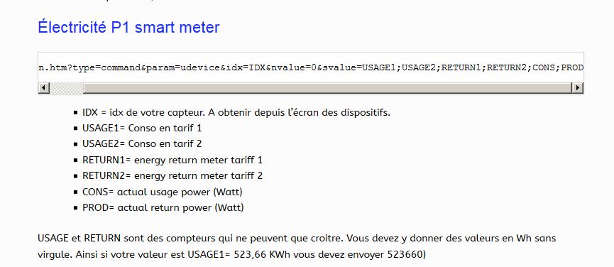

Le P1 Smart meter possède 4 différent compteur , ce qui est interessant quand tu es en contrat HP/HC . Le codage utilisé est celui ci dessous.
p1 smart meter.JPG (55.77 KiB) Viewed 38794 times
J'ai un linky et pour l'instant ma TIC est en mode historique et je tente de faire des essais pour remonter uniquement le compteur HP et HC. Dans le futur, je demanderais un passage de ma TIC en mode standard, qui va me permettre de récupérer mon compteur HP, HC et le compteur d'injection (car je suis en autoconso avec une petite installation photovoltaique). On peut aussi remonter la puissance apparente, mais aucun intérêt pour nous consommateur car c'est la puissance active qui nous est facturé..
A la base, ton code n'envoit que 2 type de données, soit l'état du compteur de base et la puissance apparente.
Je me suis lancé dans une modif de ton plugin. J'ai déclarer 6 variables pour l'historique et pour le mode standard
declaration variable.JPG (36.49 KiB) Viewed 38794 times
J'ia modifié aussi le plug in device, notamment te permettant de capturer 6 différentes données. J'ai modifié la partie v_type qui d'origne état en "dual" et je l'ai passé en "quad" mais je pense que je me trompe sur ce sujet....
plug in device.JPG (36.64 KiB) Viewed 38794 times
puis également ces modif
et la partie finale ou j'ai mis pas mal de chose en commentaire pour l'instant car j'ai eu des soucis de rafraichissement
Via le log,je vois que j'arrive à récupérer les 6 données qui m’intéresse par le plug in, mais le contrôleur n'envoit vers mon domoticz que 2 valeurs. Ca doit être super bête, et je pense qu'il suffirait de modifier un autre fichier , si tu sais m'éclairer ca serait super sympa.

#26 Post by gmella » 10 Jun 2020, 14:54
Salut seby90,
Sympa de voir tes modifs!
A première vue, j'aurai tendance à penser qu'il te suffit de remplacer event->sensorType = SENSOR_TYPE_DUAL par event->sensorType = SENSOR_TYPE_QUAD dans le switch pour PLUGIN_READ.
J'avoue qu'en relisant ton post, je me suis demandé pourquoi j'avais mis dans la partie PLUGIN_DEVICE_ADD DEVICE_TYPE_SINGLE. Probable que l'on puisse améliorer cette cohérence. Tu peux donc certainement essayer de "simplement" supprimer ma ligne qui affecte event->sensorType.
Je ne me suis pas remis sur ce plugin, mais je me suis dit qu'il reste encore de quoi l'améliorer en me demandant s'il ne devrait pas être mieux concu pour lire N etiquettes que l'on pourrait choisir avec des listes déroulantes correspondant à celles définies dans la librairie LibTeleInfo...
Mais si ca marche chez toi avec ton code on peut aussi voir pour faire une première version intermédiaire. Ce serait une première étape pour aller dans cette direction et inclure également le cas comme guy67400 en triphasé.
Bref, pour l'instant je suis curieux de voir si ca marche mieux en enlevant une ligne de code ;)
A+

#27 Post by seby90 » 10 Jun 2020, 15:50
encore merçi pour ton retour rapide, c'est cool !
Oui effectivement, on peut ameliorer le code et pouvoir chosir n etiquettes et envoyer ce que l'on désire. Mais j'avoue qu'à cet instant précis, je n'aurais pas les compétences d'y arriver seul. :P
Après mes modifs sont basiques et non pas de mérite. J'essaye de m'adapter au plus simple que tu as déjà fait et je débute sur ce type de programmation ;)
A l'occurence, tu devras essayer mais sur Domoticz , le P1 Smart Meter est vraiment mieux que les autres compteurs. J'ai tester les compteurs avec seulement 2 entrées ( dont l'utilisation de la puissance apparente )et le graphique n'est pas du tout réaliste à la vrai consommation facturée. D'ailleurs je comprends pas pourquoi la puissance active n'a jamais été utilisé sur la TIC...
Sous domoticz, le fait d'utiliser le P1 Smart Meter, sur la dernière période de 24h, pour chaque compteur il regarde le nombre de Wh qui passe durant les 5 dernières minutes et te recalcule une puissance active (donc puissance facturée) durant ce créneaux. Je trouve cela beaucoup plus précis. Puis ensuite comme les autres compteurs, te relève une conso en Kwh journalière etc... Et ca permet d'avoir 4 compteur imbriqué dans la même ligne de commande
J'ai donc fait cette modif (mise en commentaire de la ligne event->sensorType
Il y a du mieux, mais je n'envoie que 4 données au lieu des 6
Si tu as une autre idée, je suis preneur :D

#28 Post by gmella » 10 Jun 2020, 17:01
Oups, j'ai lu un peu vite.
Pour l'instant la remontée par domoticz (en HTTP) semble limitée à 4 valeurs max. Il faudrait donc construire une chaine dans le plugin pour ce mode particulier. On commence à avoir bcp de combinaisons (HISTO/STD x HC/HP x MONO/TRI) . Actuellement tu peux donc faire un peu comme guy67400 plus haut dans ce fil en utilisant SendToHTTP.
Mais c'est vrai que tout mettre dans le plugins permettrai de tirer le benefice d'un affichage sympa dans domoticz avec une mise en place très simple sur espeasy en s'appyant sur les controleurs.
