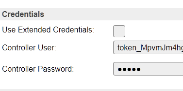

I think I've managed to sort out the issue.
I'm using BeeBotte as my remote MQTT broker.
I've found you have to insert the BeeBotte API Token in BOTH the Controller User and Controller Password boxes.
The ESP Easy release dated 20200410 - you only had to enter the token in Controller User box.
Not very secure as you can 'see' the token as cleartext.

Re: publish command not working in Rule-Sets
22 characters
e.g. token_MpvmXXXXXXXXXXeX
It includes the word... token_
The only recent change here is to allow 'extended' credentials (more characters)
22 characters is also not close to any logical limit, so it is also not related to a missing trailing zero or something like that.
It will be interesting to hear if anyone else who uses BeeBotte as their remote MQTT broker has had any problems recently.
Note:
When I use the 'extended' credentials tick-option it seems to corrupt the token in the Controller User box after I do a re-boot.
I'm sure my friend in Boston (who uses Wemos devices and BeeBotte) will be checking this issue out, so
it will be interesting to get his feedback.
Note:
