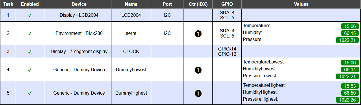

Ok, I still need to set the initial lowest value after booting so my rule looks like this now and it seems to be working.
On System#Boot do
TaskValueSet,4,1,[serre#Temperature]
TaskValueSet,4,2,[serre#Humidity]
TaskValueSet,4,3,[serre#Pressure]
On serre#Temperature Do
  If [serre#Temperature] > [DummyHighest#TemperatureHighest]
   TaskValueSet,5,1,[serre#Temperature]
  EndIf
  If [serre#Temperature] < [DummyLowest#TemperatureLowest]
  EndIf
EndOn
On serre#Humidity Do
  If [serre#Humidity] > [DummyHighest#HumidityHighest]
   TaskValueSet,5,2,[serre#Humidity]
  EndIf
  If [serre#Humidity] < [DummyLowest#HumidityLowest]
  EndIf
EndOn
On serre#Pressure Do
  If [serre#Pressure] > [DummyHighest#PressureHighest]
   TaskValueSet,5,3,[serre#Pressure]
  EndIf
  If [serre#Pressure] < [DummyLowest#PressureLowest]
  EndIf
EndOn

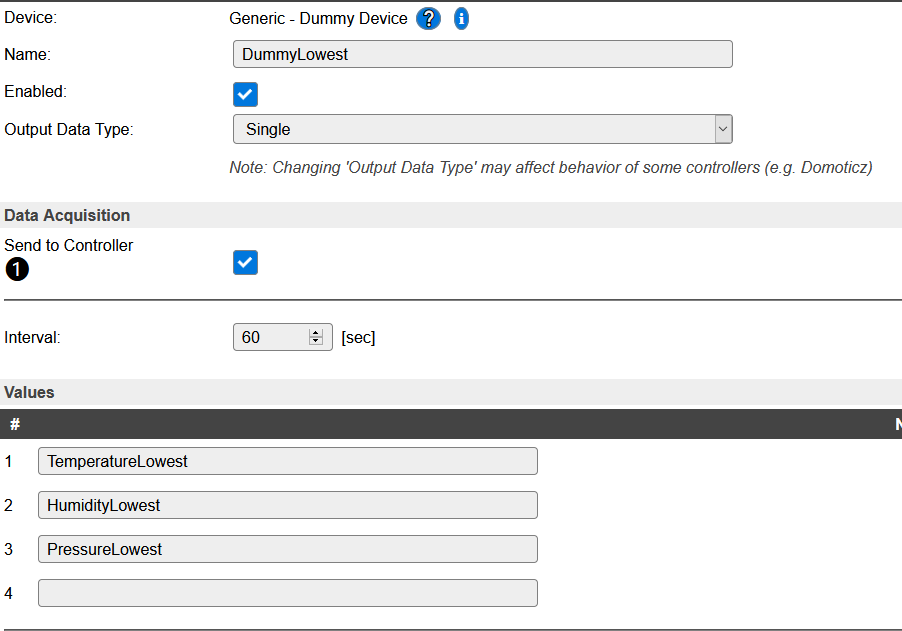

Upon testing, I discovered a bug btw. I have set 2 dummy devices with Output Data Type: Temp/Hum/Baro to create 3 task values.
After rebooting, the Output Data Type changes to Single whilst there are 4 task values all of a sudden.
Changing the Output Data Type for 1 of the 2 Dummy tasks back to Output Data Type: Temp/Hum/Baro fixes it immediately for both dummy tasks.
