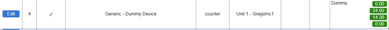

Whilst we're on the subject of ESPEasy p2p controller, here's a weird 'bug' I have been trying to fix for some time.
Here is the Devices screen for the Generic - Dummy Device on ESP1 (GregoInc1)
And here is the Generic - Dummy Device on ESP2 What I have never been able to understand is why they are different? Especially when they come from the same source i.e. ESP1?
So, on ESP1 I use the [counter#status] variable in rules to perform a function... see below.
Yet, on ESP2 the variable received from ESP1 mysteriously appears to have it's name changed from [counter#status] to [counter#Dummy] and I cannot work out why?
Thanks again for any help, much appreciated.
Grego

Re: Set Variable on Remote ESPEasy
There is a bug (a known one) regarding a very specific set of plugins, which does manifest itself also when sharing via p2p.
It is related to the plugins which allow to change the number of output values.
Dummy is one of them, just like Sysinfo and a few more.
When you first pair the tasks via p2p, it does send the configuration like value names, but that doesn't work as expected if you use one of those plugins and never changed the value name.
I never tested the calls to set variables on another node, but I don't see any reason why it should not work.
With sendto, you effectively send a command to another node.
So -in theory- it should work to send the command "let,1,123" to another node.
