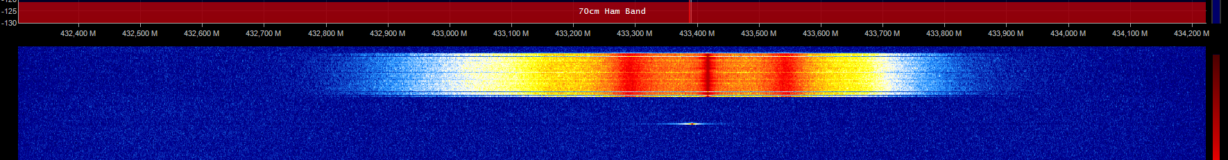

I've successfully soldered the Somfy version of RFLink Gateway, loaded the latest RFLink firmware into Arduino Mega and successfully connected the Gateway to my HomeAssistant.
The gateway should control Somfy Tilt & Lift 25 WireFree RTS CENTRAL roman blinds, but I have the same problem as this guy, and it is related to the length of signal received by Somfy motor controller:
https://community.home-assistant.io/t/r ... bit/187904
He has finally found the solution, by switching his motor from default US mode where short press of the UP/DOWN button makes the cover go all the way up or down, to the European that works opposite.
Unfortunately Somfy Tilt & Lift 25 WireFree RTS CENTRAL does not support European mode. I have verified this with the Somfy documentation.
The procedure described in Somfy manual for switching between US/EU modes for the motor mentioned in HomeAssistant forum (J406 RTS) is used to change between roman and venetian blinds modes in Tilt & Lift 25 model.
As far as I understand this issue my only way to operate the roman blinds normally is to send a shorter signal from RFLink that would imitate short button press on the remote control.
I have not found any command to shorten the signal transmitted by RFLink.
Any alternative solutions do not work, eg. with RTSLONGTX=ON command is still way too short as my blinds are almost 3meters long and multiplied signal repetitions makes the blinds to roll very slowly (not in full speed) with many stops between commands received.
I'm attaching the graph from RTL-SDR that shows the difference between a signal sent from the Somfy remote control (the small one on the bottom) after which the blinds go all the way up or down and one very strong and long RFLink signal that is causing that blinds move just a little bit for the time of the transaction length - ie. few centimeters and stop just after the transaction ends.
Could you pls help me with this issue?

Re: Somfy Tilt & Lift 25 WireFree RTS
There are several reports detailing the behavior you comment on.
It seems clear that the blinds have 2 working modes:
Changing the EU/US mode allow you to modify the UP/DOWN behavior in RFLink (discrete/continuous).
But if I am not mistaken, the RFLink implementation does not support the TILT function of blinds, so it is not possible to control both functions (UP/DOWN & TILT) using RFLink.10.2 Using a Telis RTS remote control
By default, the Mod/Var receiver is delivered in “US” mode. When Telis RTS remote
control is being used:
- Briefly pressing (< 0.5 seconds) on the ˄ or ˅ button of the Telis RTS remote
control will cause the blind to go up or go down to the end limit.10.3 “Europe” mode
- Pressing and holding (> 2 seconds) the ˄ or ˅ button of the Telis RTS remote
control will cause the slats to tilt.
Using a remote control in “Europe” mode:
control will cause the blind to raise or lower to the end limit.
I wonder if it will posible to implement in RFLink the TILT function.
Recently RFXCom has implemented this functionality: @fholding, maybe your remote's debug traces can help to see the differences in UP/DOWN and TILT signals: Refs:
