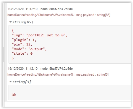

Just noticed that from ESP Easy release 221016 onwards MQTT (OpenHAB) seems to be publishing what looks like a log and the topic-name has not resolved the system variables.
My rule-set works fine with releases up to this date, but not after it.
I'm using ESP_Easy_mega_20201022_normal_ESP8266_4M1M on a Wemos D1 Mini, although ESP_Easy_mega_20201130_normal_ESP8266_4M1M shows this behaviour as well.
- Screen Shot 12-19-20 at 11.34 AM.JPG (37.95 KiB) Viewed 12374 times
Re: MQTT publishing a 'log'
That probably has to do with the GPIO command being moved to be an internal command.
Previously the GPIO commands were part of a task and a task has a taskname and valname.
However as it is now a global command it no longer has a taskname and a valname and thus it cannot be substituded.
Can you give a bit more info on what is no longer working here?
It looks like you're receiving a GPIO command from the broker and the reply is now sent back to the source (this part is fixed in the latest code, not sure if it is present in a nightly build)
But sending a reply on a command should not break functionality, so I wonder what may be the cause of things no longer working in your setup.

I've tried with ESP_Easy_mega_20201130_normal_ESP8266_4M1M and can operate the GPIO pins by sending 0 or 1 to the topic.... homeDevice/command/gpio/12
In fact I can control the GPIO pins with... homeDevice/command/cmd/gpio/12 as well !!!
Which is the correct format?
It's the single string "Ok" that's messing up detecting the type of MQTT message received in Node-RED.
Top part is in json format, lower part is just a piece of text.
As a workaround I've found if I clear the Controller Publish entry it sorts out my issue (as I'm using a Rule to do the publishing).
- Screen Shot 12-19-20 at 11.52 AM.JPG (37.67 KiB) Viewed 12372 times
