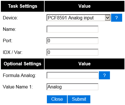

Please do not refer to this article, I did not get it.
What is a domoticz device page? How do I set up?
Why do I not see any IDX/Var? my ESPEasy looks different than this, there is no more IDX:
Thank you very much for your help!!!
