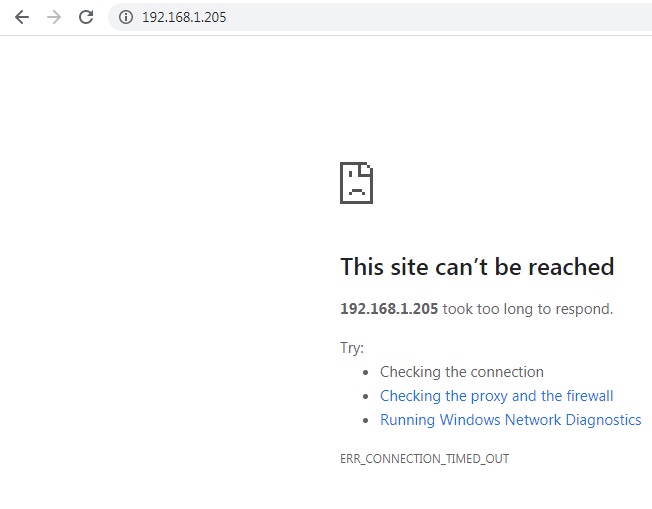

now every time i send command from domoticz , esp dont work and in domoticz log : ||(ip 192.168.1.205)
so i want open esp on web and i see this : (ip 192.168.1.205)

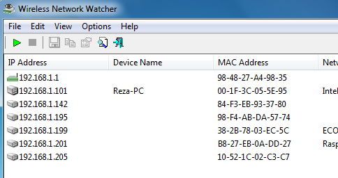

but i open the "wireless network watcher app" for see which device is connect to my network, so i see that deivce (ip 192.168.1.205) is connected to my network...
my last router never had this issue . setting in domoticz and esp is same setting with last router. just in my network my router is change (means esp and domoticz and distance and channel , all is ok and dont change)
