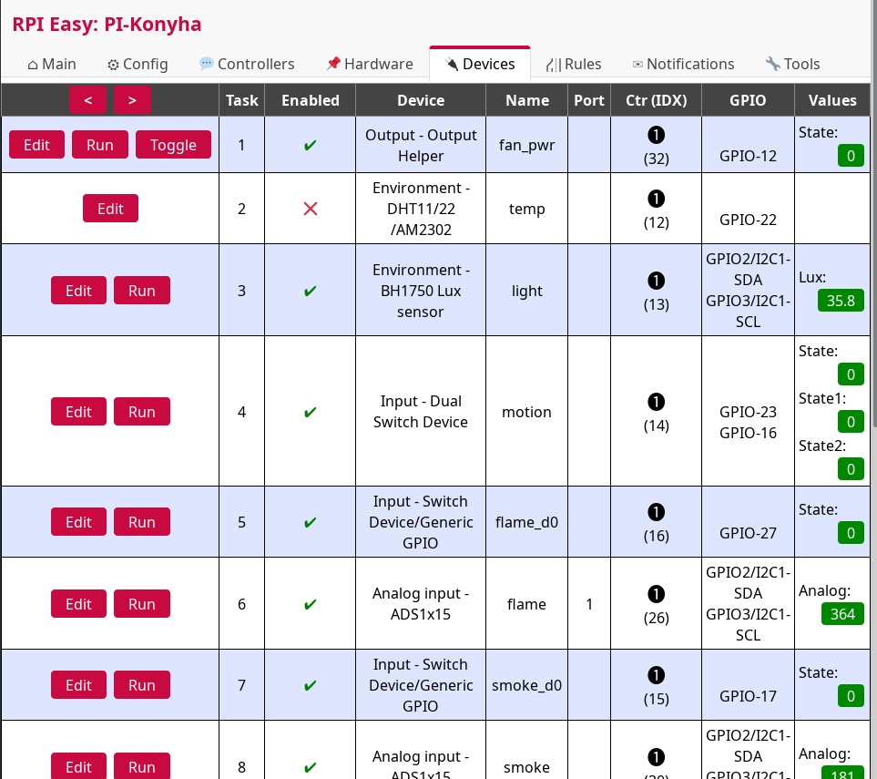

A new plugin is added in the end of the year. With Dash plugin the locally added Tasks can be visualised in a table.
Plugin interval defines the page refresh rate, page can be accessed by IP/dash or can be setted to force itself as startpage.

Hmm that run button is also a good idea to have in ESPeasy.

TD-er wrote: 31 Dec 2020, 17:18 Hmm that run button is also a good idea to have in ESPeasy.
Yep, it simply executes taskrun command. :)
And the next button Toggle is for binary outputs only, changes state between 0 and 1.

budman1758 wrote: 05 Jan 2021, 16:54 Thats a great idea! I just updated on of my units but can't seem to be able to access it. How do you enable this?
Add some tasks that generates data, than add a P212 Dash plugin and setup:
- Size (table)
- Data type [ Text, Binary input/read only, Switch output/changeable, Meter, Gauge, Slider output (dimmer), Select output (has to fill displayed and send values) ]
- Data source (select task+value name)
If the type supports, you can also add "unit" or min/max values.
The result can be accessed at http://ip_addres/dash
