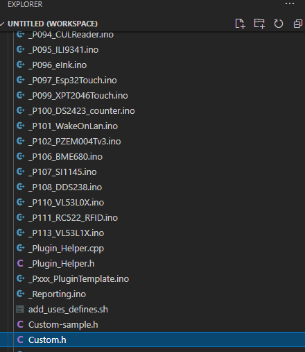

I successfully flashed the build_output\bin\ESP_Easy_mega_20210420_custom_ESP8266_4M1M.bin
And was able to get on the AP and configure my WiFi.
For ESP8266/ESP8285 you can edit pre_custom_esp82xx.py and for ESP32 you can edit pre_custom_esp32.py
Alternative is you copy Custom-sample.h to Custom.h (in the same foulder you find Custom-sample.h), and un-comment all the options and plugins you want, set your local WiFi credentials so it will connect automatically, etc.
Should I be able to configure my WiFi and set options and plugins via the pre_custom_esp82xx.py?
Posts: 9888
Re: Custom Build using PlatformIO?
#6 Post by TD-er » 20 Apr 2021, 15:19
If you want such specific settings, you may want to have a look at the Custom-sample.h and rename it to Custom.h.
The build process detects whether this file exists and will use it for "Custom" builds made in PlatformIO.
Setting string-like configuration like passwords is a bit tricky in a Python config file, so for that it is better to use the Custom.h route.
You may also keep a copy of Custom.h somewhere for yourself to make it easier to create your own builds.
The file will never be overwritten by Git checkouts, but just to be sure it is best to keep a copy somewhere else too as you will probably use that file a lot :)

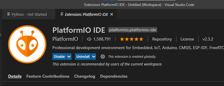

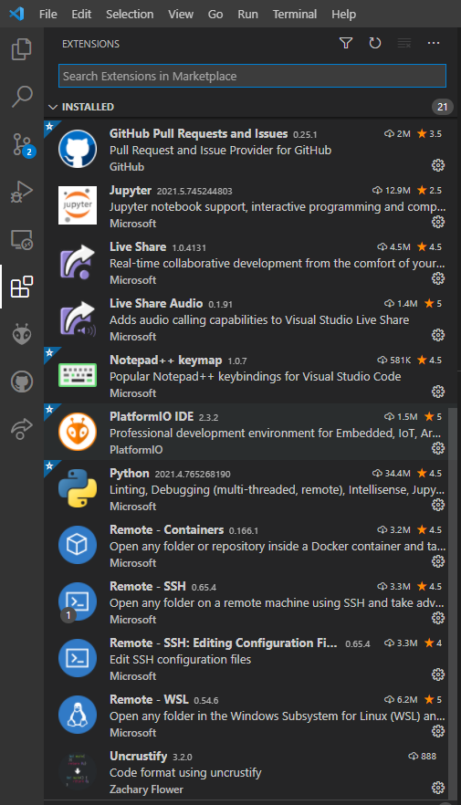

TD-er wrote: 20 Apr 2021, 15:12 Then you probably have not installed PlatformIO in your VS code.
It is under the "extensions" in VS code.
Installation of PlatformIO does take a while and needs a restart of VS code.
See also: https://www.youtube.com/watch?v=ArqwMcYSMsU
Here is my extensions in VS.
Screenshot 2021-04-20 091704.png (119.65 KiB) Viewed 9049 times
If I click the extension it gives me the option to Uninstall.
Screenshot 2021-04-20 091857.png (42.14 KiB) Viewed 9049 times
I did follow along with the youtube video provided.

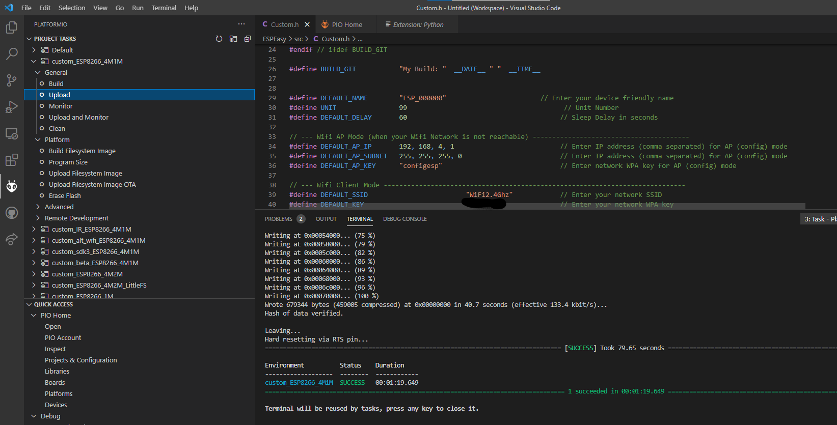

I copied and saved Custom-sample.h as Custom.h
Screenshot 2021-04-20 101610.png (31.52 KiB) Viewed 9040 times

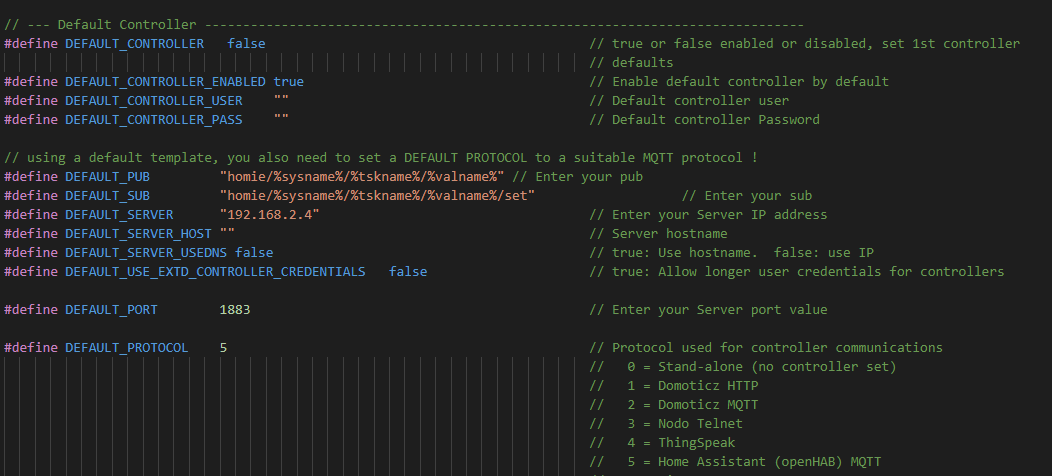

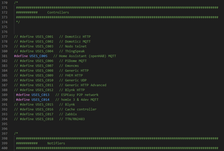

I configured the Custom.h file with my network settings and enabled some of the Controllers
Screenshot 2021-04-20 102017.png (62 KiB) Viewed 9040 times
After uploading using PlatformIO none of my settings have taken.
Screenshot 2021-04-20 102317.png (64.58 KiB) Viewed 9040 times

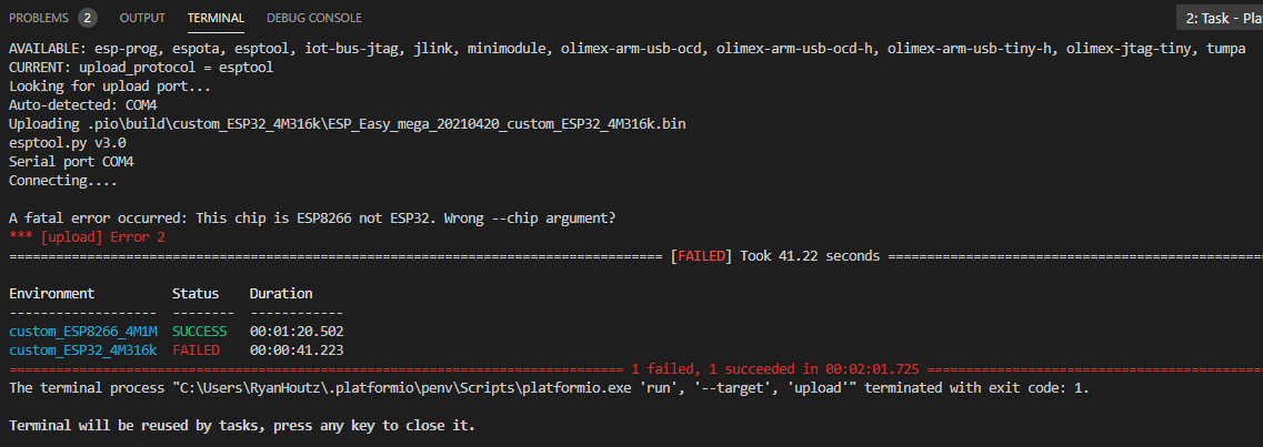

The terminal shows the custom_ESP8266_4M1M was a success
Screenshot 2021-04-20 102930.png (34.86 KiB) Viewed 9040 times
I'm not using any ESP32 devices so if I can get it to quit trying to use that it would be great.
Thanks again for all your help.

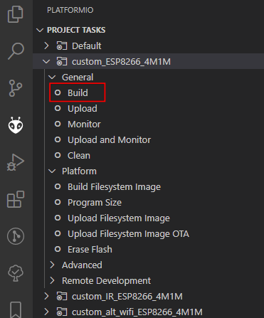

You should best build (or upload) from the PlatformIO menu:
Screenshot - 20-04-2021 , 15_58_19.png (18.36 KiB) Viewed 9038 times

#12 Post by rmhoutz » 20 Apr 2021, 17:09
Got ya. I used the Upload under project tasks but the device still booted back up into AP and didn't have my Wifi settings.
After I connect to my Wifi using a tablet it will then connect to my network but doesn't have any of the other settings I configured like NTP and MQTT.
Screenshot 2021-04-20 110239.png (143.74 KiB) Viewed 9035 times
Posts: 9888
#13 Post by TD-er » 20 Apr 2021, 17:13
I wonder what you mean by the settings not being used...
If you refer to those "DEFAULT_..." defines, those are only used when creating a new instance of whatever they refer to.
So you may need to perform a "factory default" (See tools page) to create a new settings file where all your DEFAULT_xxx defines are being used.
You may first want to check you actually have uploaded the latest build (see Tools->Sysinfo page, the build time)
When you just recompile only a few changed files, you may want to do a "clean" build first in PlatformIO (option is shown on Ath's screenshot) and then perform a new build or else the _BUILD_TIME_ may not be reflecting the actual build time.
I find uploading via PIO quite simple to do as you then have feedback whether an update was successful, which may not always be clear when doing an OTA update.
