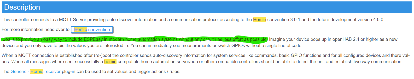

Is anyone using the Controller Homie MQTT convention with Openhab version 2.5 or 3?
I recently installed some TP-Link switches in my home and found Openhab picked them up without me telling it to look.
After that it took very little additional configuration to get them integrated into the system.
It was exactly as described in ESP Easy documentation for the Homie Controller.
https://espeasy.readthedocs.io/en/lates ... omie#setup I believe this is still in testing if I'm not mistaken, I'd like to help the development anyway I can.
I'm not a programmer but I can test and report back my findings.

I'm really hoping I'm not the only one using this firmware with OpenHAB, the silence isn't very reassuring.
I'm following the troubleshooting steps found in the Homie MQTT convention page.

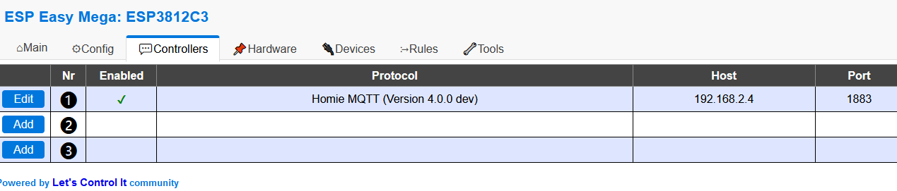

Guys I had given up on this but after I got my system back up and running after the OH2.5 to OH3 migration I revisited it this morning.
And I actually figured out the problem.
I was so close to having this configured properly a week or two ago I can't believe I missed it.
The instructions talk like homie works with openHAB MQTT and when I was configuring a custom.h the correct option in my mind was to use option 5.
Since I'm running a OH3 server and OH3 docs mention not needing anything more than the MQTT addon to use homie devices.
I was attempting to use the Home Assistant (openHAB) MQTT protocol when I should have been using Homie MQTT protocol as seen below.
Does anyone know how I can add that to be an option for the default protocol?
I'm thinking about creating a ESPEasyHOMIE.bin that is ready for use with Homie.
Users will just need to configure devices and personal network settings.
But after that OH3 should detect the device just like it does with TP-Link devices.
Thanks again for all the work you do on this.
I first watched all 11 videos provided in the link and that for sure helped me understand what's going on better with MQTT.this guide for me has been very readable and informative: https://www.hivemq.com/mqtt-essentials/
Re: Homie Auto-dicover with OpenHAB3?
The default controller you can set in the Custom.h is the nr of the controller (C005 => 5, etc.)
So if you need the Home 3/4 version, you have to use "14" there.
https://github.com/letscontrolit/ESPEas ... ino#L8-L26
The default controller will be added when generating a new config, like when you start fresh or reset to factory default.
