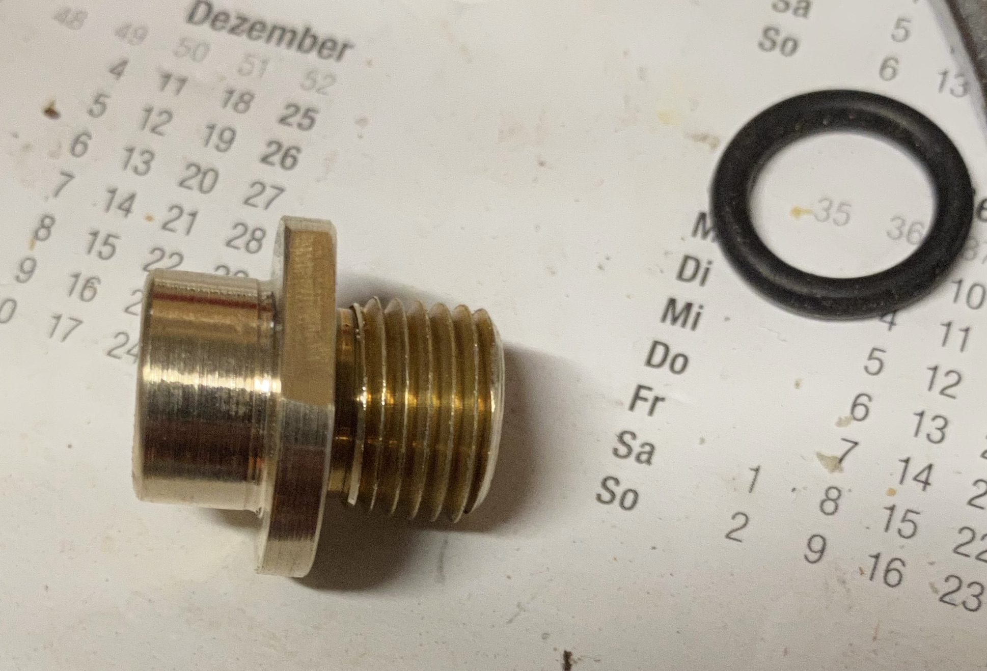

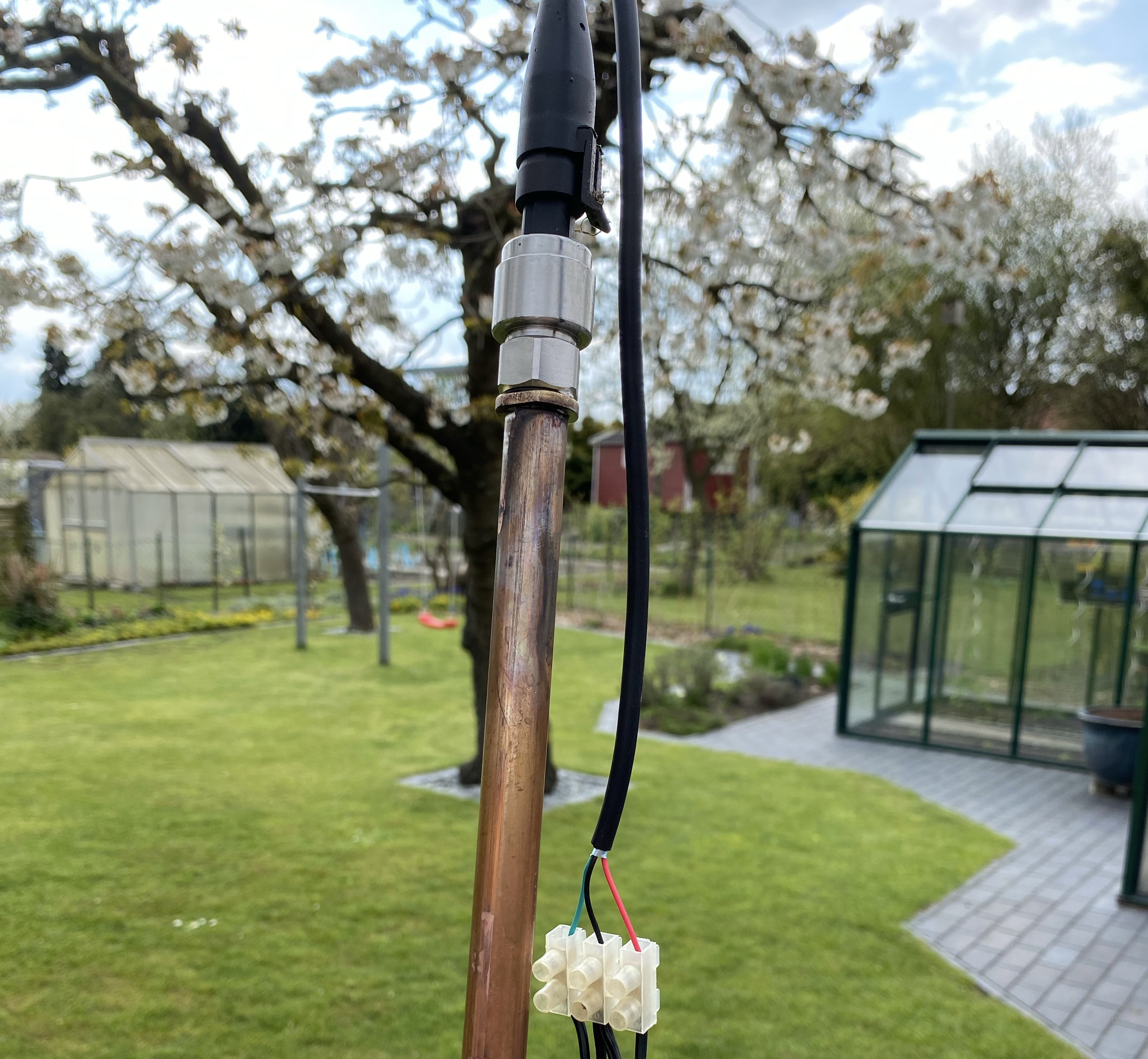

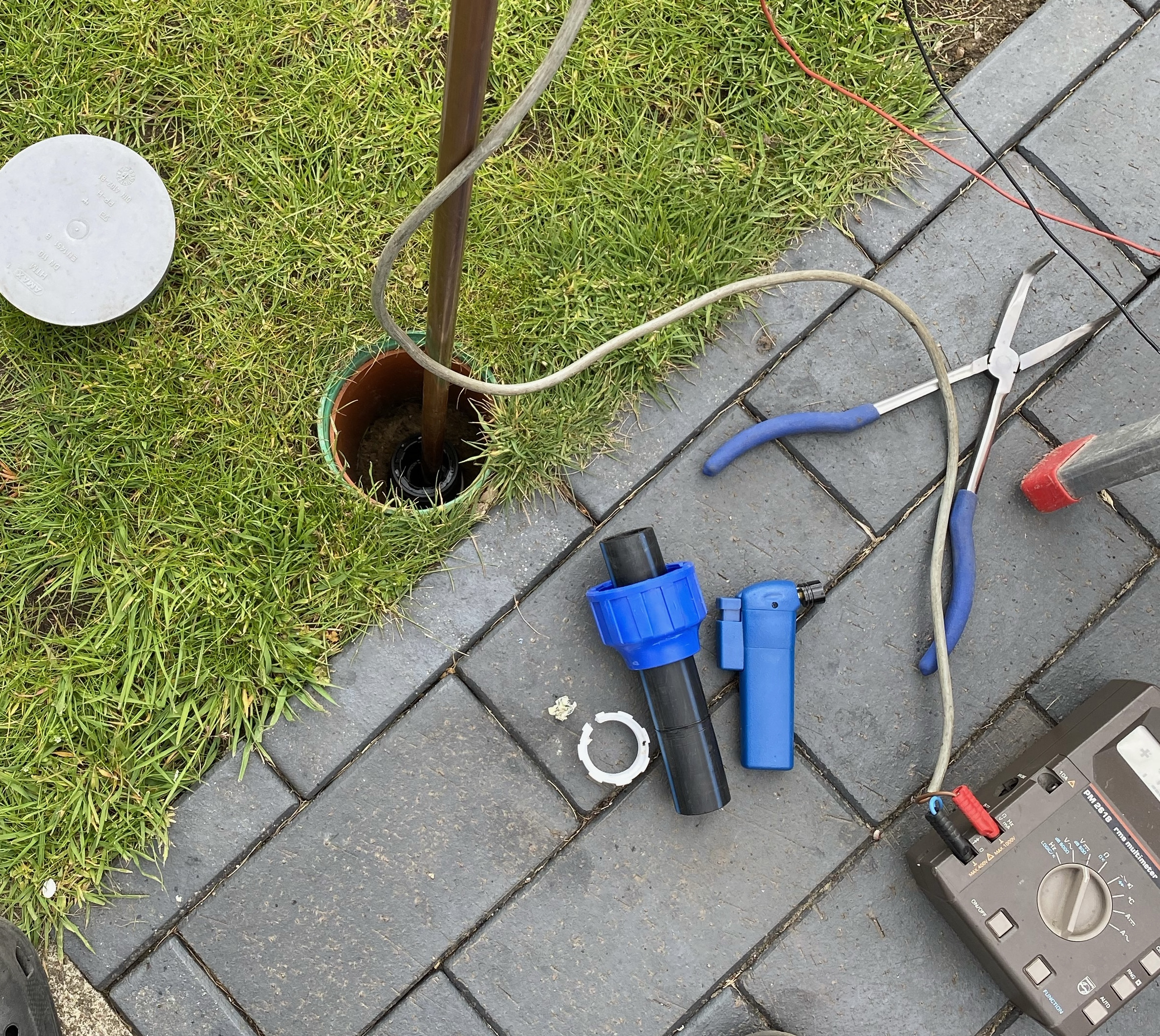

I got the sensor and made the first test, here are some pictures.
First I had to build an adapter between the copper pipe and the sensor. Then I assembled all. The copper pipe is 4,25m. The actual water level is 2,45m. The copper pipe should stay 1,8m in the water and the sensor output I got is 745mV. Then I started the pump from the new well. The level goes down and the output also to 638mV. To calibrate the system I will check the water level when the pump is running.
What I could see is that the value of the sensor output is fluctuating between 3-8mV. I hope if I add some capacities it would be less. Next step I will isolate and to fix the cable. The length to the esp is about 6m. I think I could use the analog input without any voltage divider. I the moment after the winter time the water level is at the maximum and during summer it would go down, so the output will also go down. Only if the water level goes down more than 4,25m I have to make the copper pipe longer. But this will see in the summer.
Best regards!

Thanks for the update.
For such low voltage signals, it is best to have the wires carrying the signal as short as possible and maybe it also helps to twist the cables.
This twisting will help reducing the noise picked up along the line as the induced voltage will be negated a few cm further along the line.
Adding a capacitor may also help, but keep in mind that an empty capacitor will act as a "short circuit" when a voltage is applied.
So have a good look at the schematic to see if any part can be shorted to GND without issues.
