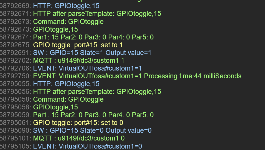

Today I tried to assign a GPIO as a switch. My intention was to be an output switch.Defined a new task, gpio15 as "switch", "normal switch". After that tried the toggle command via http. Response: "Failed" in browser. In log we have:
58221346: HTTP: GPIOtoggle,15
58221347: HTTP after parseTemplate: GPIOtoggle,15
58221349: Command: GPIOtoggle
58221350: GPIOtoggle,15
58221351: Par1: 15 Par2: 0 Par3: 0 Par4: 0 Par5: 0
58221352: GPIO : port#15 is not an output port
Strange...
Tried with http commands:
http://192.168.4.32/control?cmd=GPIO,15,0
http://192.168.4.32/control?cmd=GPIO,15,1
Response OK:
After that device responds normally on gpiotoggle command:

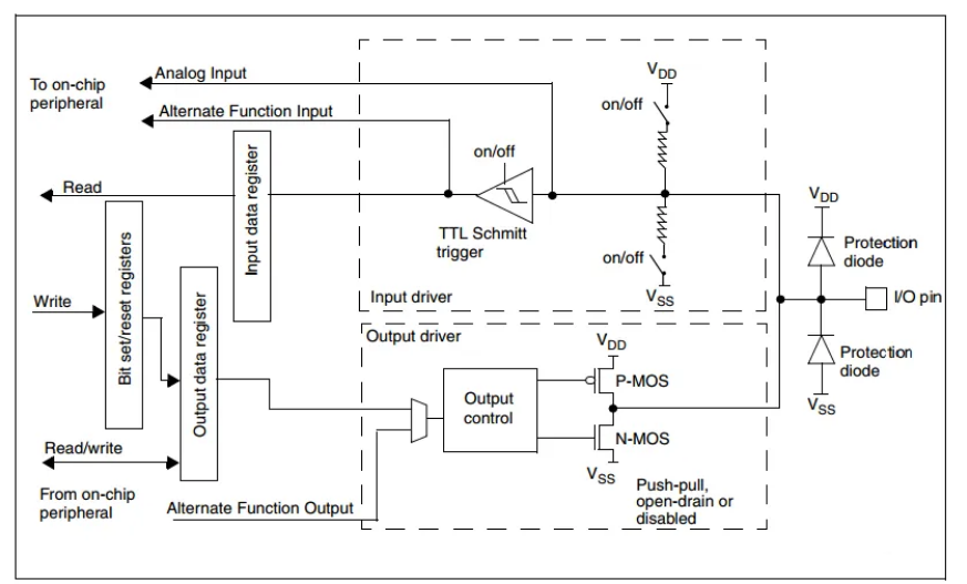

I'm hardware orientated, so it's somehow difficult for me to understand. For my point of view, input and outputs are totally different things.The behaviour of a certain pin should be well defined at boot.If it's an input ,then CPU will monitor the logicall level of that pin, the internal output driver should be disabled,or High-Z. If is an output, then the the pin will be driven by internal driver of that pin.[strong pull up/down, push-pull...] You say: "the "switch" plugin can put the pin into "input" mode" "For toggling using the "GPIO" command, you don't need to assign a switch plugin on that GPIO pin to a task.". But I need the "output#state" of that gpio for further mqtt use in a specific format."The state of "2" is setting it to be an input, so setting it to 0 or 1 is setting it to be an output."
I think things should be more clear.
When a gpio is assigned as switch input, then the internal driver(output transistors) should be in high-Z, state2 ,as long the task is enabled, and the pin act as an input, internal logic levels follows the voltage applied on that pin (that scenario also involves pullup/pulldown resistors- weak pull up/down)...
When a gpio is assigned as output,then the output transistors can generate or absorb current,push-pull, they follow the logic levels of internal buffer,register.
