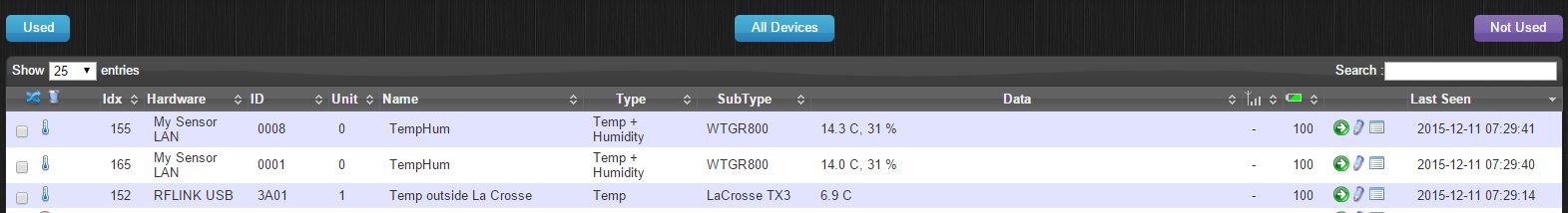

I added a DS18B20, so now I have a NodeMCU 1.0 with DHT22 and DS18B20.
This is what I get in the Devices tab of Domoticz
213 MySensors 0005 0 TempHum Temp + Humidity WTGR800 21.0 C, 40 % - - [Add Device] [Rename Device] [Log] 2015-12-10 23:01:11
212 MySensors 0000 0 TempHum Temp + Humidity WTGR800 19.3 C, 40 % - - [Add Device] [Rename Device] [Log] 2015-12-10 23:01:11
211 MySensors 0004 1 Humidity LaCrosse TX3 Humidity 37 % - - [Add Device] [Rename Device] [Log] 2015-12-10 22:01:14
I don't know where the LaCrosse (211) comes from. 212 is the DHT22, is correct.
213 is supposed to be the Dallas, but it kind of inherits the humidity of 212.

Now I know what bert has it seems the names of the sensors are incorrect and also the values.

Some more testing.
@ Bert, with the serial monitor I see no reset and all values of the connected sensors give good values or status as shown in the ESP EASY interface.
As I did not trusted the devices found in the DMZ devices and setup I removed them all.
Removed the device and added it again.
Switch on hardware detection in DMZ and all prevoius sensors are there again but are not the sensor ESP EASY shows in the interface.
