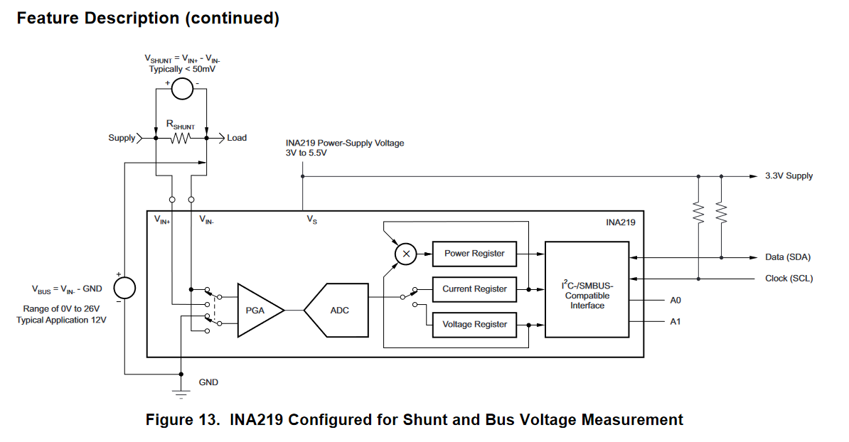

Ina schematic
The +voltage(max 26v) goes to ina V+, shunt to V- then goes to load. Ina measure V+ and current through shunt (V+,V-).

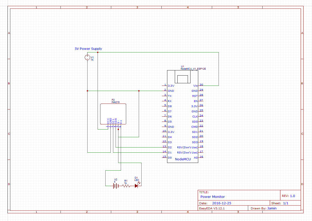

In the second schematic, with the NodeMCU, there is no wire from 3v3 to Vs,
If powering the INA219 with 5V (not sure if that works...) you may risk setting the high of SDA and SCL to 5V and thus frying other sensors connected to the I2C bus.
Please double check this.

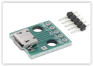

Using one of these USB breakout mini-adapters might be the answer as you could feed your main 5V supply to the breakout adapter
then wire in the INA219 and then route the wire to the 5V IN on the NodeMCU. The 0V / GND would be common. I can draw a rough sketch if you need one.
