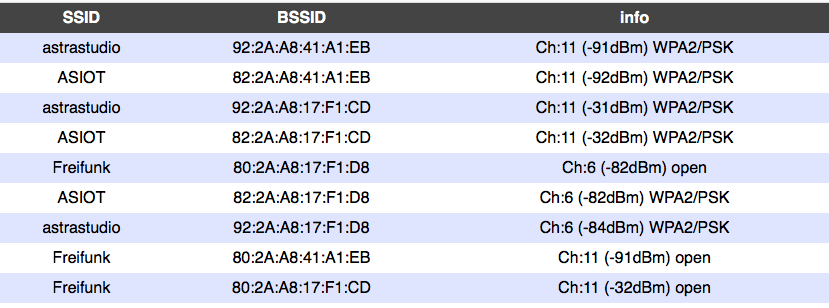

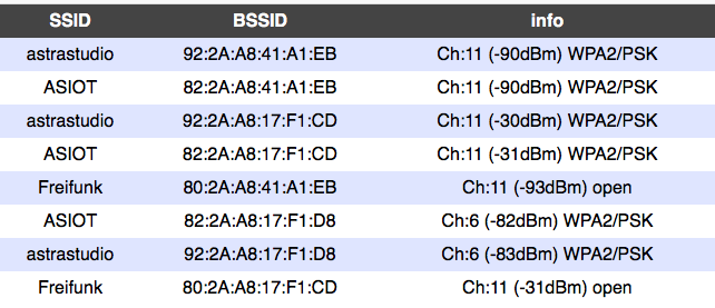

I have a similar issue. However, erasing all flash/config did not help.
It looks to me that the ESP does connect to the AP with the lowest channel, regardless of the signal strength.
In my testcase the ESPEasy sees 2 APs with both the same SSID. One on channel 1 with -79dB and one on channel 11 with -52dB.
It always selects to the one with the lowest channel, not the strongest signal.
How is this possible? Is ESPEasy in charge of selecting the APs or is it a ESP8266 function/method that selects the AP?
Could ESPEasy always do a scan and select the BSSID with the strongest signal for a SSID?
What else could be wrong?
Kind regards Sascha

#21 Post by TD-er » 20 Jun 2018, 21:59
At this moment ESPeasy does do a scan and selects the first from that scan result.
I was under the impression this list was sorted by signal strength, but apparently it isn't.
If you do a WiFi scan from within ESPeasy, is the list then sorted by signal strength? (that's one call that does set the sorting order)

#22 Post by Methuselah » 22 Jun 2018, 13:26
Mine doesn't sort by signal strength, it sorts by channel:
N00b to the world of ESPEasy, but I've been programming since the days of punch cards and paper tape :)
astrastudio
Posts: 5
Joined: 20 Jun 2018, 14:36
Re: No ESP Easy connection to my other WiFi access points with same SSID
#23 Post by astrastudio » 22 Jun 2018, 14:12
It looks to me like the sort is actually not a channel sort, multiple scans gave different results.
It looks more like completely random. But at least not ordered by signal strength.
The "ASIOT" is the network that the ESP should connect to, as you can see the unit has an ASIOT on 82:2A:A8:17:F1:CD with -32dBm, however it is connected to the really bad signal on 82:2A:A8:41:A1:EB which only has -92dBm.
Bildschirmfoto 2018-06-22 um 14.05.25.png (77.03 KiB) Viewed 51381 times

#24 Post by astrastudio » 22 Jun 2018, 14:16
If I scan again, here is the slightly different result.
Bildschirmfoto 2018-06-22 um 14.03.02.png (68.45 KiB) Viewed 51371 times
#25 Post by TD-er » 22 Jun 2018, 19:14
OK, so there should be some change on this.
Random selections is not what we want.
