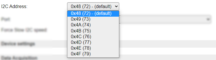

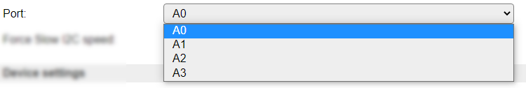

I've created a pull-request ([urlhttps://github.com/letscontrolit/ESPEasy/pull/3734]#3734[/url]) to improve the UI on this selection:
Address selection: Port selection:
