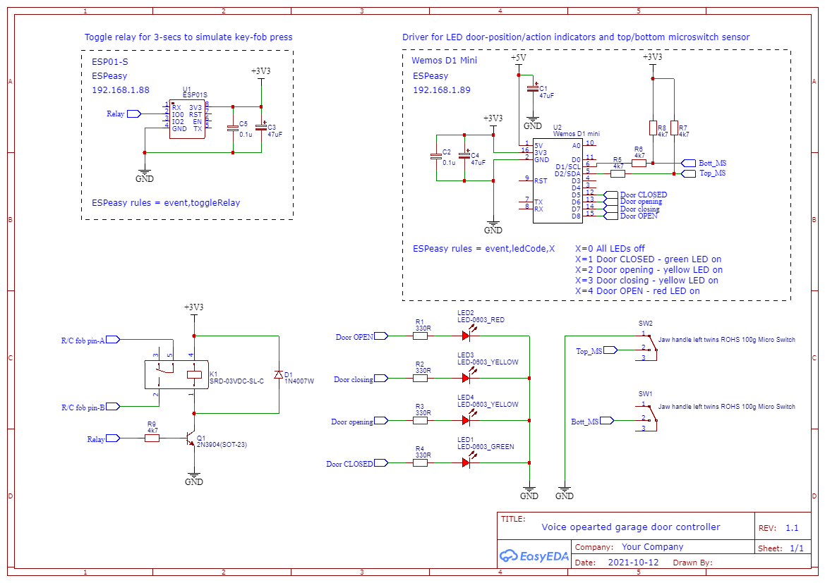

I'm actually using a Wemos D1 Mini fitted with a 4Mb chip and an ESP01-S to create a voice-operated garage-door controller.
Schematic_Garage door controller_2021-10-13.png (95.21 KiB) Viewed 13418 times

Looks like a fun project.
Be sure to disable internal pullups on D1 / D2.

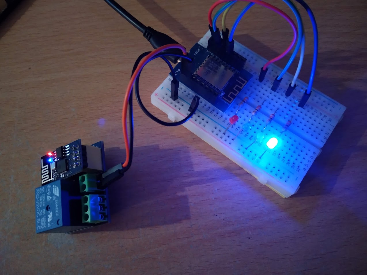

#7 Post by dynamicdave » 16 Oct 2021, 20:21
Well it is developing into a fun project.
I'm using Alexa with some nodes in Node-RED, so I can say things like... "Alexa, open garage door" or "Alexa, close garage door"
I dropped one of the remote control key fobs the other day - broke the plastic case - BUT the electronics still works.
So rather than throwing it away I took it to pieces and found the place where the push-button switch joins to the PCB.
Soldered some wires, so if you touch them together for 3 or more seconds - the garage door is activated.
I'm using a relay on the ESP01-S to simulate the key-fob being pressed.
I installed a couple of microswitches at the top and bottom of the door's travel so I can detect where it is.
I've had the door (sort of) working today - but the rules aren't triggering the publish to MQTT.
