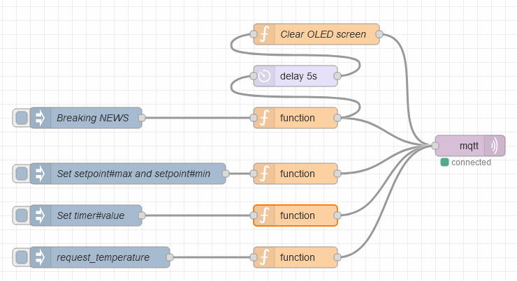

Basically what I have is a 300-second timer.
Every time it expires (every 5-mins) it will collect a temperature reading and sends it, via MQTT, to Node-RED where it is stored in a MySQL db and shown on a graph.
Node-RED can send an event to change the time interval to say 15 (seconds) so the updates happen more rapidly.
What I was trying to do was make the change to the time-interval become active from NOW, rather than having to wait until the current time runs out.
Using the... event,rules#timer=1 achieves this and means the system's response is very rapid.
I can now go on and apply the same technique to setting the max and min setpoints from Node-RED.
The final project is going to be a Room Temperature Display system (RTD).

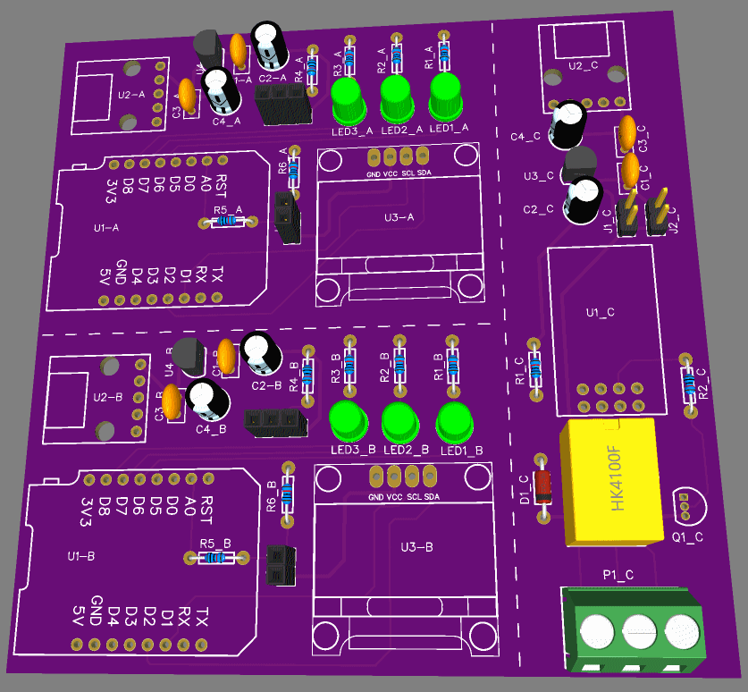

Here's a pic of the prototype and the PCB (which has two RTDs and a piece of spare circuitry).
I've also attached a section of the 'test flow' that runs in Node-RED.
Thanks to everyone for their help and advice.

- Screen Shot 11-05-21 at 07.31 AM.GIF (26.66 KiB) Viewed 12075 times
- A_Room_temp_and_display.GIF (71.01 KiB) Viewed 12082 times
