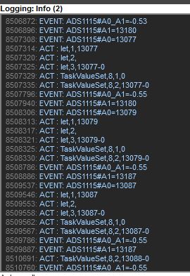

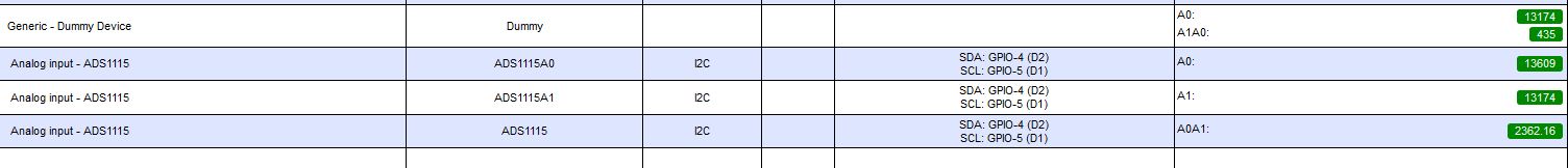

Hi there,
I would like to use the ADS1115 to record the analog signal of the ACS712 current sensor a little more precisely.
With the rules I cannot offset the A0 port with the A1 port.
Only one value is ever assigned to a variable.
The offsetting by the ADS115 A1-A0 works, but I cannot calculate an average.
The transfer via task device to dummy is only possible with one port.
What am I doing wrong?

- Rules.JPG (17.99 KiB) Viewed 7865 times
- Log.JPG (41.22 KiB) Viewed 7865 times
- Device.JPG (61.01 KiB) Viewed 7865 times

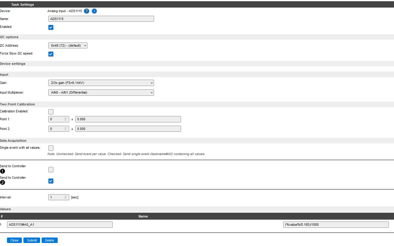

You should not try to name your Value "ADS1115#A0_A1", that's surely going to mess up somewhere unexpected.
And also, each task must have a unique name, they should not all be named ADS1115 !
And do you have different I2C addresses set for each task? That's also kind of required for the ADS1115 to work correctly, as when the all try to address the same module at nearly the same time, it will have a similar effect as running the unit at too high I2C clock speed.

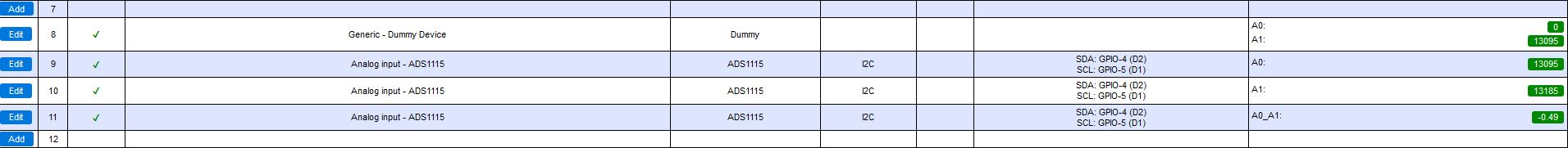

Hello Ath, thanks for the quick reply.
The first part has already helped, thanks!
Now looks like this:
That was just for testing
Another question, how do I determine the correct current value in Amper with the formula?
My formula doesn't work, a voltage divider is installed on A1 that halves the voltage.
I didn't understand that, the ADS1115 sensor only has one IC2 address.And do you have different I2C addresses set for each task? That's also kind of required for the ADS1115 to work correctly, as when the all try to address the same module at nearly the same time, it will have a similar effect as running the unit at too high I2C clock speed.
On ADS1115A0#A0 do
let,1,[ADS1115A0#A0]
let,2,[ADS1115A1#A1]
let,3,[VAR#1]-[VAR#2]
TaskValueSet,8,1,[VAR#2]
TaskValueSet,8,2,[VAR#1]-[VAR#2]
%value%/0.185
- A1A0.JPG (44.32 KiB) Viewed 7859 times

The ADS1115 plugin is indeed a bit different from other plugins as it handles the complete measurement in a single call and thus you can have different tasks using the same chip only different ports.
That's probably not what you want as ADS1115A0#A0 gets updated, but you're also storing the last known value of ADS1115A1#A1 which is probably not yet updated when you call it here. (or it may be updated but not yet processed in the rules)
