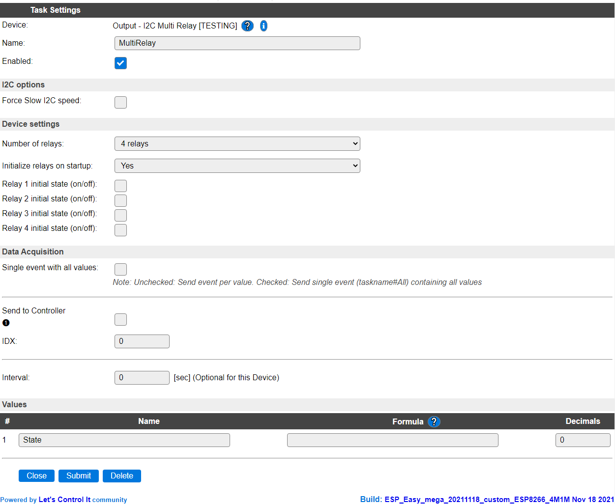

I've put in some legwork, so this is what I've ended up with:
The settings screen:

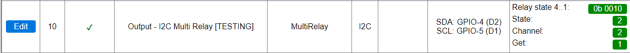

The Devices overview (not actually tested as I don't own the hardware)

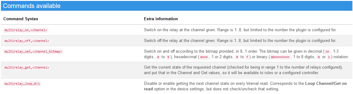

I implemented both options, so you can use the command "multirelay,get,<channel>" and get the Channel and Get state (0/1) in 2 extra variables. Or use the command "multirelay,loop,1" to enable updating the channel on each Interval and read the next channel state. That last feature is also an option in the Device Configuration.
A snippet from the help:

And a snippet from the Devices page:
