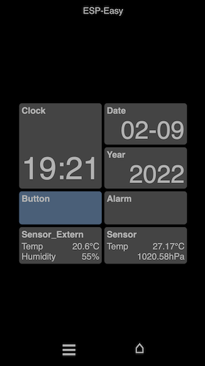

You mean like this?:

2. Will be nice to add the °C / °F next to the temp (φ / RH next to humidity ?)
If I were you I would move somewhere cooler :)
Looks good (perhaps align - top?)

iron wrote: 27 Jan 2022, 18:07 Can't see an actual use on any of the sliders since they do not survive cold reboot unless the devs give us this feature
I forgot to mention, that you do not necessarily need to use these sliders as an input. they can be used as display as well.(e.g waterlevels , batterylevels, remaining kwh,.....)
give the slider a min and a max as described earlier and use
TaskValueSet,Waterlevel,slVal,<value>
to set the value.
Same goes for the buttons. They can be just a visual feedback of a state. In the picture e.g. you can see if the pump is running or not depending on the tilecolor...
To do the clock and date tile:
give a dummy device a name containing bigVal and name two values clock and date (with two decimals)
the code would look like this:
on Clock#Time=All,**:** do
Taskvalueset,bigVal,1,%syshour%.%sysmin_0%
Taskvalueset,bigVal,2,%sysday%.%sysmonth_0%

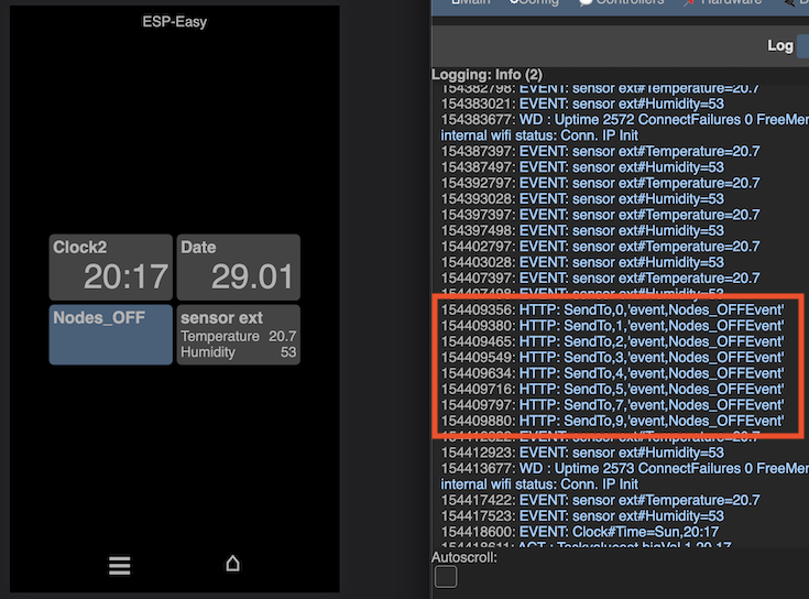

Because you have quite a lot of relays so it seems, it gave me an idea.
I added a new Button that is generated by naming the first value "allNodes". It will send an event to all connected nodes.
This button is colored and will call an event "Taskname+Event" and "Taskname+Long" on long press.
e.g.:
