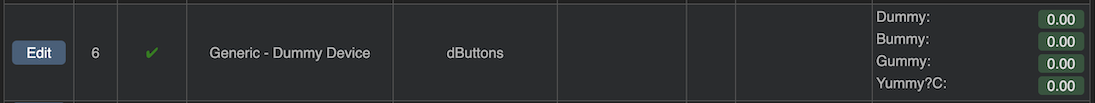

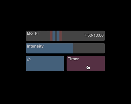

There is a new test.html with some new features for testing:
What’s new:
- url parameter: add ?unit=<unitnr> to the url to directly access a node (good for bookmarking)
- up to 4 buttons with one dummy: Name a dummy device something that consists "dButtons" and every value becomes a button.
You can add an option for colorbuttons with "?C"(see picture below)
- add a thingspeak value to display the last value of a field of a public thingspeak channel, use this scheme for a value-name: "name&<channel>&<fieldnumber>" optional you can give it a unit of measurement with ?<unit of measurement> (like in every other field):
- take the red pill: long press the house button and it will bring you to the devices webui without fetch...

#112 Post by chromo23 » 01 Mar 2022, 15:54
small update to dButtons:
- add "&<nodenumber>" to the valuename and the button send its events (normal or long) to the corresponding node.
Edit "&A" will send an event to all connected nodes (it replaces the "allNodes" dummy-device)
Bildschirmfoto 2022-03-01 um 15.49.29.png (32.66 KiB) Viewed 128565 times

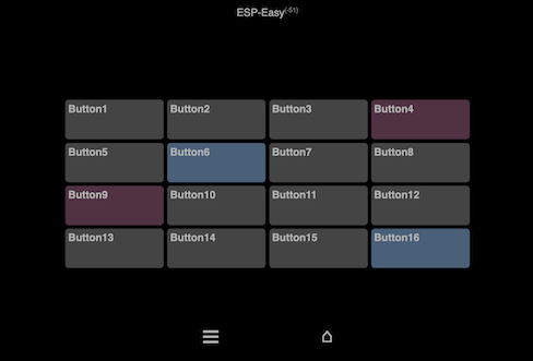

Buttonmania:
Bildschirmfoto 2022-03-01 um 16.16.51.png (32.93 KiB) Viewed 128562 times

I wanted to integrate an easier way to create a toggle-button in easyfetch.
Currently you have to add a rule for a Button to work:
On ButtonEvent Do
  GPIOToggle,14
For this new behavior you just name the value of a "switch"-device "bntState" + "?" + the gpio you want to toggle (e.g. "btnState?14")
It creates a tile that sends the toggle command.
The problem is, that the "GPIOToggle"-command doesn´t work when the gpio is already set in the devices page.
Is there a workaround for that?
Bildschirmfoto 2022-12-04 um 19.08.48.png (79.92 KiB) Viewed 124678 times
Bildschirmfoto 2022-12-04 um 19.09.05.png (32.02 KiB) Viewed 124678 times

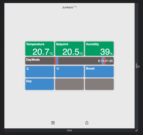

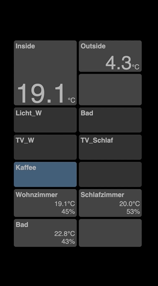

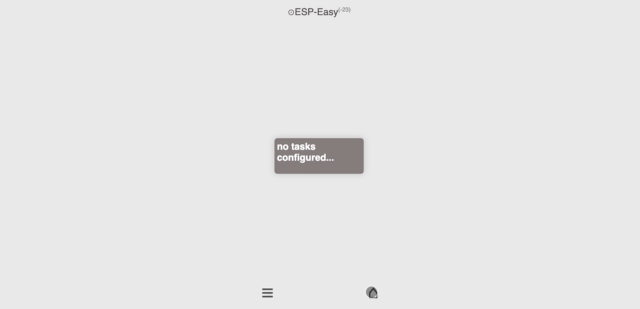

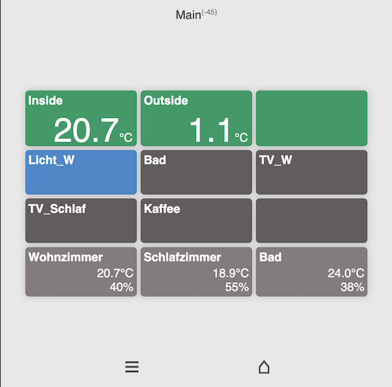

#136 Post by chromo23 » 13 Dec 2022, 12:37
I did some changes in code structure, functionality and appearance.
- new color-scheme for light mode
- simple toggle switch when adding a switch plugin without using rules,
available since the latest builds (if "Inversed Logic:" is set the value-name needs to be changed from "State" to "iState")
if you have an old build use "btnState" + ? + "gpio Number" instead (e.g. btnState?12)
(i also prepared a PWM slider but that needs pin states in json)
- number input (name a dummy-device "vInput"), enter a number and confirm with "enter" or "click" on the upper part of the tile
- always-square - layout always puts empty tiles automatically at the end to make it square
- sysinfo in the nodelist
- create empty Tiles in dButton and vInput that hides in mobile mode by entering "noValAuto" as a value-name (just "noVal" crates an empty tile without this ability)
Edit: almost forgot... the cron plugin is now properly visualized

#137 Post by chromo23 » 22 Dec 2022, 12:14
Tip of the day:
You can use easyfetch more dynamically by enabling and disabling certain tasks dependent on user interaction.
(For now we have to link the device that needs to be en- or disabled with another device which keeps a state but in the latest builds it is possible to retrieve the state of a taks in rules. See here: https://github.com/letscontrolit/ESPEasy/pull/4421 This allows even more sophisticated scenarios.)
Here a very simple code example:
On TimerEvent Do
  If [dButtons#Timer]=0
    TaskValueSet,2,2,2
    TaskEnable,3
  Else
    TaskValueSet,2,2,0
    TaskDisable,3
  Endif
And the result:
Another example (a countdown timer for a light):
