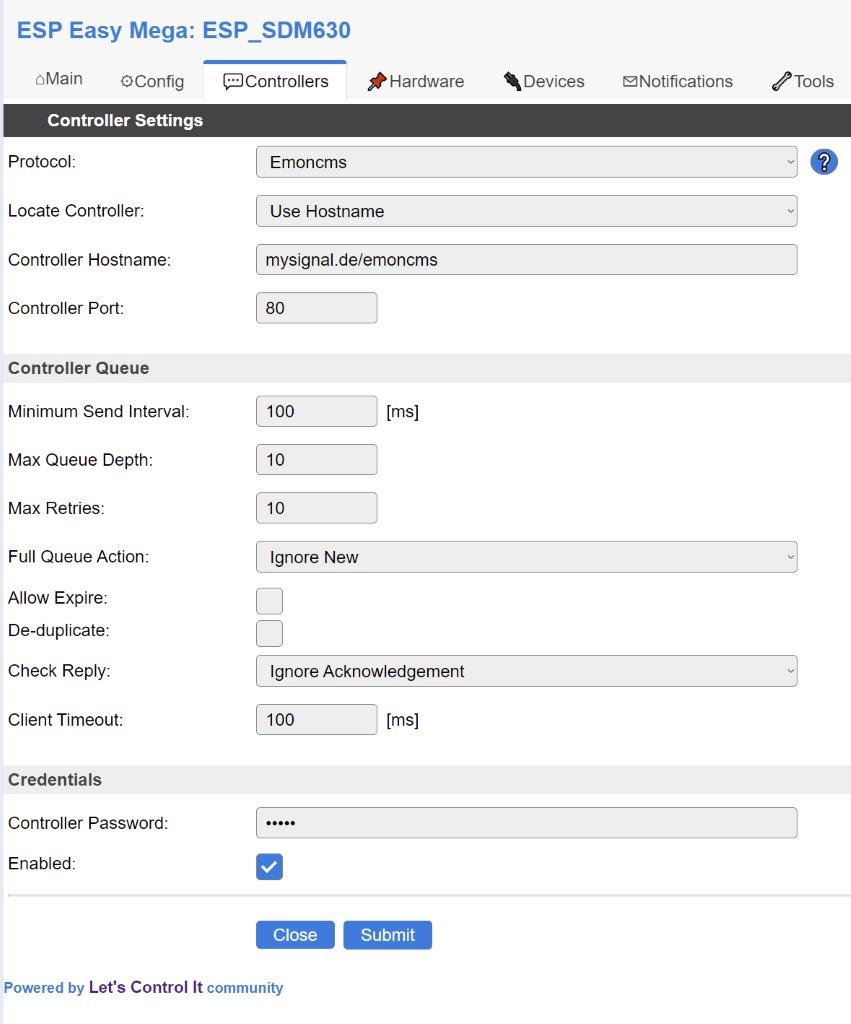

Re: Connection to EMONCMS not working
If that server is on the internet, like the url suggests, then the Client timeout setting should be increased to a more realistic value of 1000 msec, or maybe even higher, as you won't have the predictable delays you can see in a local network.
It may help to set global debug level to DEBUG, instead of the default INFO, though I haven't checked if that outputs additional info for this Controller.
Okay, now I have increased the value from 100 to 4000ms (maximum), but it looks like the same.
I have installed it on the folder public_html/emoncms on the my side mysignal.de and the sample API-URL looks like that:
https://mysignal.de/emoncms/input/post? ... key=xxxxxx
Is the hostname mysignal.de/emoncms correct?

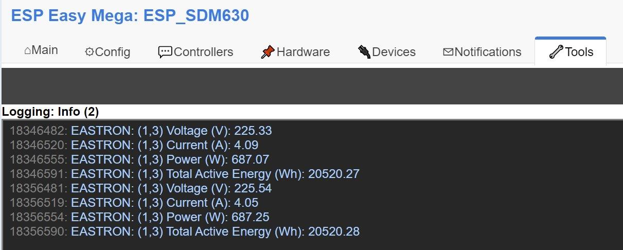

Logging Output:
and the JSON Output:
I hope it helps to find the failure.
Logging Output:
29126481: EASTRON: (1,3) Voltage (V): 228.55
29126518: EASTRON: (1,3) Current (A): 5.00
29126555: EASTRON: (1,3) Power (W): 987.67
29126608: EASTRON: (1,3) Total Active Energy (Wh): 20522.23
29131989: WD : Uptime 486 ConnectFailures 0 FreeMem 15624 WiFiStatus WL_CONNECTED 3 ESPeasy internal wifi status: Conn. IP Init
29132845: LoopStats: shortestLoop: 339 longestLoop: 1541127 avgLoopDuration: 483.88 loopCounterMax: 88495 loopCounterLast: 60426
29132845: Scheduler stats: (called/tasks/max_length/idle%) 60426/2036/8/86.58
29136481: EASTRON: (1,3) Voltage (V): 228.65
29136519: EASTRON: (1,3) Current (A): 4.92
29136554: EASTRON: (1,3) Power (W): 886.61
29136608: EASTRON: (1,3) Total Active Energy (Wh): 20522.23
29146481: EASTRON: (1,3) Voltage (V): 228.64
29146518: EASTRON: (1,3) Current (A): 4.81
29146553: EASTRON: (1,3) Power (W): 891.06
29146608: EASTRON: (1,3) Total Active Energy (Wh): 20522.24
29156481: EASTRON: (1,3) Voltage (V): 228.46
29156518: EASTRON: (1,3) Current (A): 4.83
29156554: EASTRON: (1,3) Power (W): 883.08
29156608: EASTRON: (1,3) Total Active Energy (Wh): 20522.24
29161956: WD : Uptime 486 ConnectFailures 0 FreeMem 15624 WiFiStatus WL_CONNECTED 3 ESPeasy internal wifi status: Conn. IP Init
29162845: LoopStats: shortestLoop: 339 longestLoop: 1541127 avgLoopDuration: 491.53 loopCounterMax: 88495 loopCounterLast: 59505
29162845: Scheduler stats: (called/tasks/max_length/idle%) 59505/2032/8/85.79
29166481: EASTRON: (1,3) Voltage (V): 228.58
29166519: EASTRON: (1,3) Current (A): 4.81
29166554: EASTRON: (1,3) Power (W): 883.70
29166609: EASTRON: (1,3) Total Active Energy (Wh): 20522.24

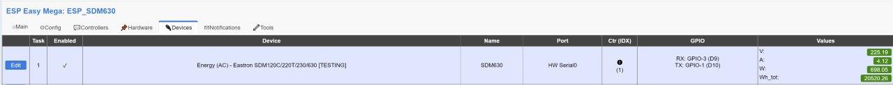

Here please:
- Device_Settings.jpg (215.1 KiB) Viewed 8337 times

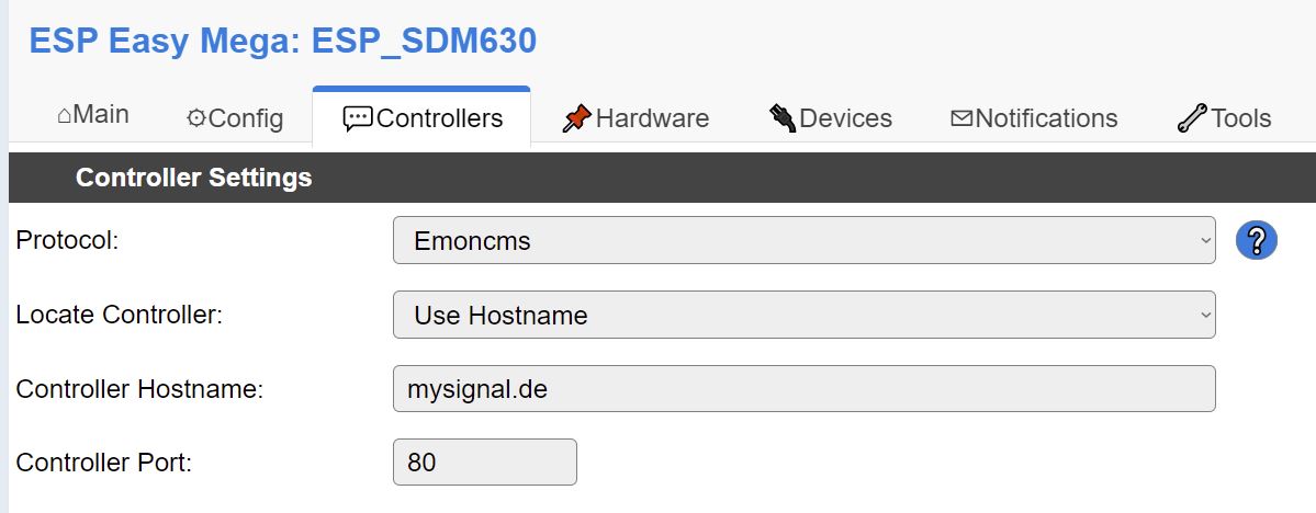

Now I found the second failure, on the field hostname I must use only 'mysignal.de' without subfolder or HTTP.
Thank you for your help
