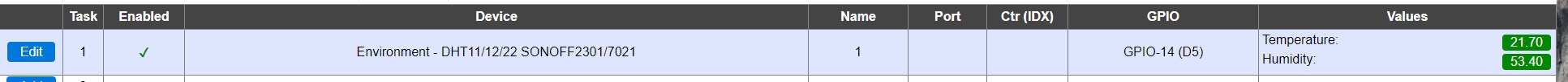

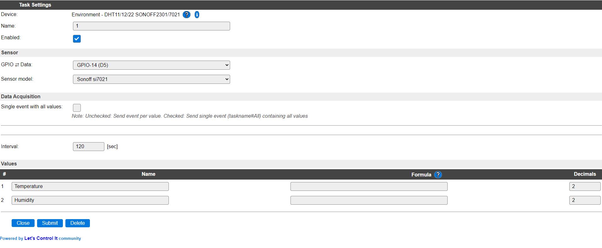

Just bought a Sonoff TH16 (v2.1) with the Si7021 sensor. I tried adding the 7021 as an I2C device but i got a constant 0/00 / 0.00 temp/hum reading (so yeah, it's not a I2C bus sensor).
I've added it as a DHT11/12/22 SONOFF2301/7021 with GPIO-14 (D5) and it started showing the values but very rarely, "nan / nan" shows up very often in the devices table.
build: ESP_Easy_mega_20210114_normal_ESP8266_1M (tried with the newer but same results).

Can you verify that the wiring of the sensor is ok, f.e by moving the sensor to see if it works better, and also check if the connector on the TH16 isn't dirty, corroded or otherwise making a bad connection? And if possible, try another sensor?

I'm new to ESPEasy but havenow managed to get my Sonoff TH16 +Si7021 to show a valid reading on the Task screen. The problem is that the vast majority of the time I get these NaN values for the TEmperature and Humidity - in fact I have only seen proper values once! I haven't changed anything since and I am waiting for another one!
In the Log I am getting DHT: No Reading
I have GPIO Data set to GPIO-14 (D5) for the Sensor in the Task and Sensor model set to Si7021
