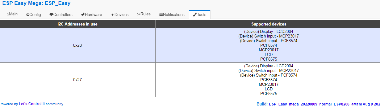

#12 Post by asuz » 19 Aug 2022, 22:02
Ath wrote: 19 Aug 2022, 21:59 And what does the I2C scan from the Tools page show?
Re: Countdown timer on LCD
#13 Post by Ath » 19 Aug 2022, 22:06
That looks fine, and what if you put some text in Line 1? Does that show on the display?
asuz
Posts: 175
Joined: 31 Oct 2018, 18:22
#14 Post by asuz » 19 Aug 2022, 22:08
Ath wrote: 19 Aug 2022, 22:06 That looks fine, and what if you put some text in Line 1? Does that show on the display?
Yes

Maybe I could not describe my problem exactly;
Right now device settings of the LCD is;
Line 1:Please put 3 coin
Line 2:Inserted coins:[pulse#Total]
Line 3:
Line 4:Rest time [var#300#d3]
And the rule is:
on startTimer do
  loopTimerSet,1,1,301 // stops after 301 seconds
on pulse#count do //
  if [pulse#Total]>=3 and %v301% = 0 // Don't allow to re-trigger when blocked
    Let,301,1 // Block re-trigger until the timer has finished
    Event,startAction
on Rules#Timer=1 do
  Let,300,301-%eventvalue2%
  // Lcd,4,11,"[var#300#d3]"  // update display, handled by interval=1
  if %v300%=0 // last count results in 0
    Event,stopAction
    Let,301,0 // Unblock
on startAction do
  GPIO,13,1 // Start Relay
  LCD,3,1,"Motor activated"
  asyncEvent,startTimer // start the timer
on stopAction do
  GPIO,13,0 // Stop Relay
  LCD,3,1,"               " // Clear text
  ResetPulseCounter // Restart counter
