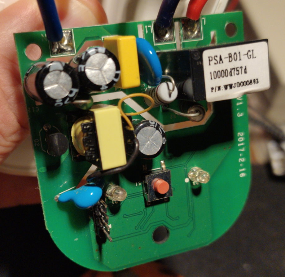

After a quick read it seems that ceramic capacitors have the lowest life expectancy. So i guess it's either one of the blue ones on the frontside or some unidentified SMD capacitors on the back side.
Which one would you suspect to be troublemaker? A wild guess?

The cylindrical black ones surrounding the transformer thingy.
Please take note of the polarity. When used with reverse polarity their life expectancy is even worse and rather explosive too.
Can you see the mentioned temperature on the side?
The capacitance and the voltage are important when looking for replacement.
The capacitance should be at least what's written on the side and the voltage also at least what was used here.
Problem when you pick one with either higher capacitance or higher voltage is that those will be larger and probably won't fit in that tight spot.
Also with the caps so close to the transformer, I think my estimated average working temperature may be a bit low.
The blue droplet shaped one is probably a varistor. (voltage dependent resistor)
It is often used to protect against voltage spikes.
Even if that one is broken/blown, it won't affect the performance of the unit. Unless it is causing a short, but then you would probably see other indicators like magical smoke, blown fuses, etc.

One of these capacitors i had lying around (the single one on the right which is 330uF and 16V).
I changed it... no smoke... or fire... and it works again like nothing ever happened.

That's the one on the output of the power supply.
The one that's probably the most likely one to make the voltage unstable.
However the other ones will eventually cause issues too. Perhaps they have a higher tolerance.
