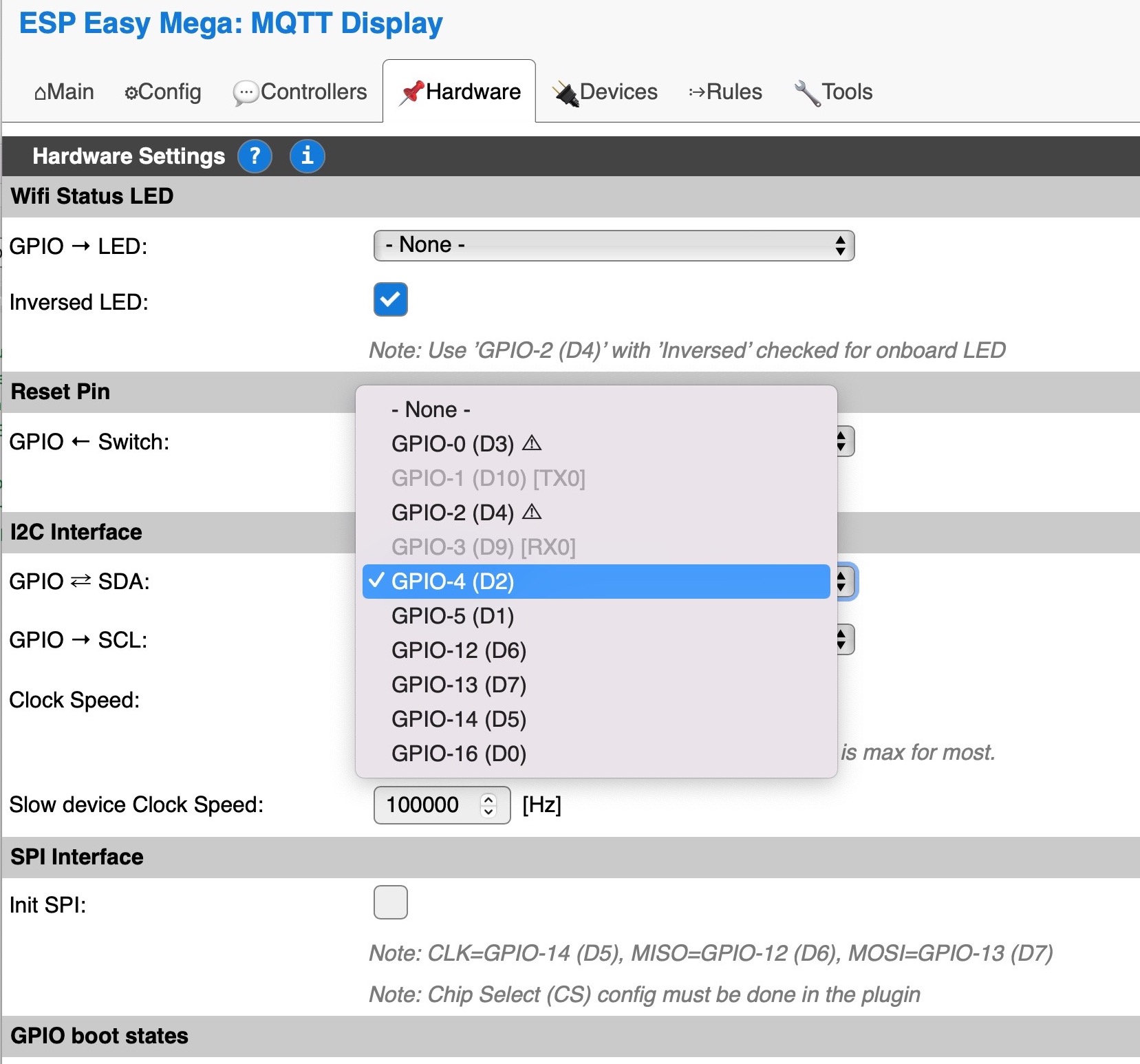

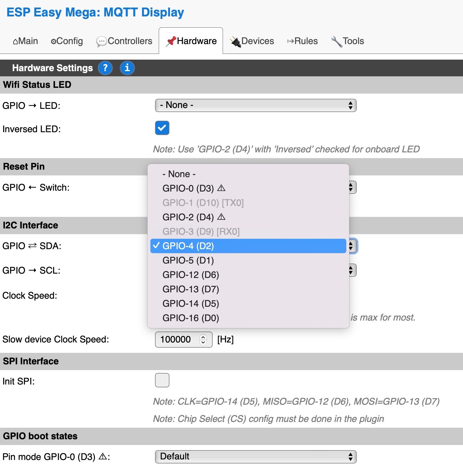

Hm, I flashed the ESP with your firmware, but in the menu I find no I2C Multiplexer option? Or will it only appear when I connected the multiplexer?
Re: ESP8266 and 2 OLED 0,96" displays
#10 Post by Ath » 10 Dec 2022, 16:21
You have to configure it at the Hardware page first (select the TCA9548a on I2C address 0x70), then it will be visible in each I2C Device Configuration page

#12 Post by bastler11 » 10 Dec 2022, 18:21
I looked first at the hardware page, there is no TCA9548a to select?
#13 Post by Ath » 10 Dec 2022, 19:30
I have installed the .bin file on an ESP8266 before attaching it to the post above, are you sure the right .bin file got installed?

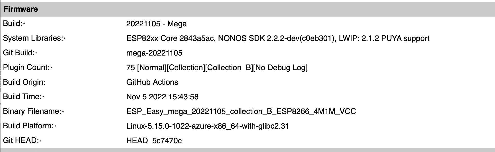

This is the content, I installed the 1. file
#15 Post by Ath » 10 Dec 2022, 20:28
Re-installed the same file from the archive I attached, this is from the Tools/Info page:
Screenshot - 10-12-2022 , 20_24_31.png (18.33 KiB) Viewed 8925 times
And on the Hardware page I have this:
Screenshot - 10-12-2022 , 20_25_45.png (24.6 KiB) Viewed 8925 times

I tried it again 2 times, there is still the file from 05.11?
#17 Post by Ath » 10 Dec 2022, 21:06
Can you use the Tools/Firmware Update button, then use the Select file (or your local translated text, like Datei wählen ?) and browse to the correct .bin (or .bin.gz, same effect) file, select the file and click the Update Firmware button to install that on the ESP.
