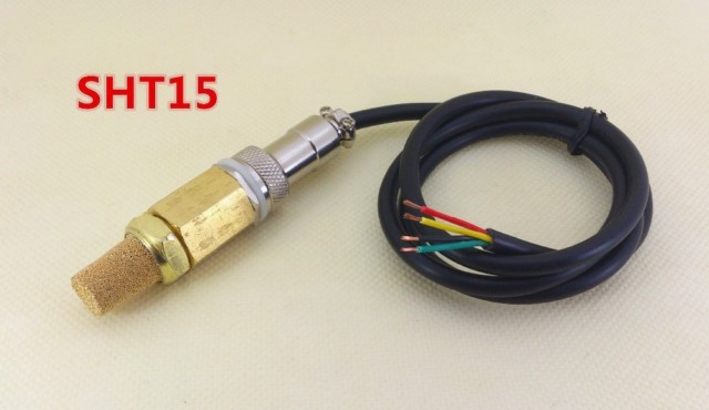

The T&H-sensors of Sensirion type SHT3x are good choice (also considering trade-off performance vs. cost), and often used in the 'better' Meteo-systems.
SHT4x is the even better variant.
SHT3x can be purchased enclosed within protective capsule, which should enable them to survive longer, especially in outdoor environment:
as illustration shown below for SHT15, but comparable layout might be applicable for SHT3x
In outdoor application it is prudent to additionally install them in 'weather hut' like from TFA, Davis or Barani, to shield against direct rain and direct sun.
In fact the demise of 'my' BME280 probably also caused because it was 'naked' to the outdoor environment although inside a housing.
In that perspective to be expected that within a few years the replacing BME280 will break down,
although now probably earlier end-of-life for the SDS011 (because in use since 2018).

Thanks for the info Ton.Ton_vN wrote: ↑15 Dec 2022, 19:21 The T&H-sensors of Sensirion type SHT3x are good choice (also considering trade-off performance vs. cost), and often used in the 'better' Meteo-systems.
