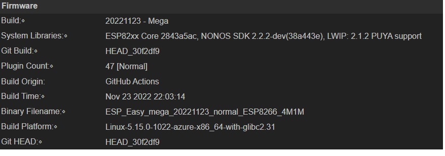

OK. Using the action build @TD-er linked.

EVENT: Clock#Time=Thu,9:20
69180823: ACT : sendtohttp,'http:
69180827: SendToHTTP: Invalid port argument: 0 will use: 80
69180833: HTTP : SendToHTTP GET... failed HTTP code: -1 connection failed
69180840: EVENT: http#=-1
