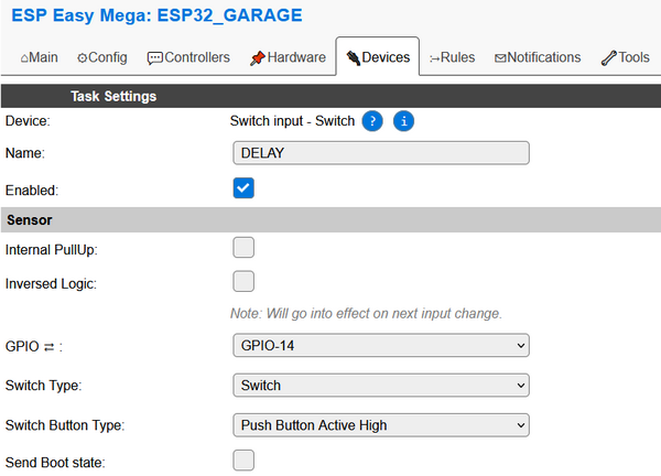

I have a switch of type "push button active high" named "DELAY" on the GPIO-14.
When I press this button, I change a "state" value from 0 to 1 or vice versa.
How can I also set this "state" value to 0 using a ruler?

I don't think the variant with "taskvalueset" is the best. I'm new to EspEasy, I have the impression that the "taskvalueset" function changes a memory value and not the value stored in the GPIO14.
I set the button connected to the GPIO14 to "Switch Button Type:" as follows: "Push Button Active High". This changes the value at each push. So far it works well.
But I would like that when I enter my final function that the value returns to zero.

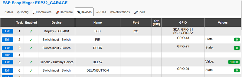

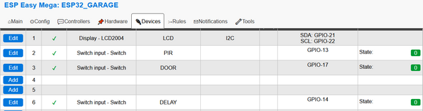

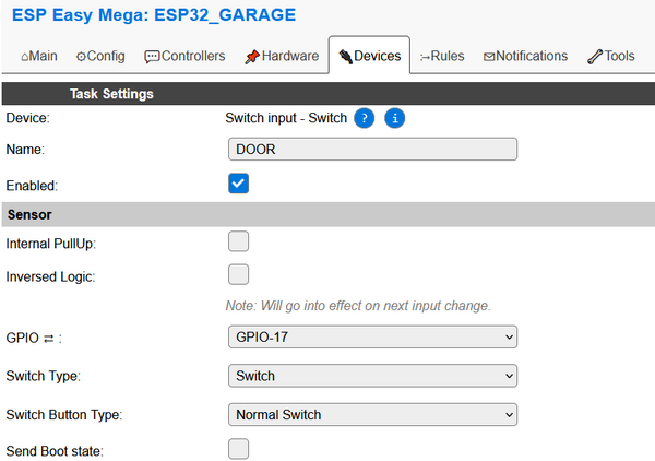

Re: "push button active high" swith to 0 with Rules
Can you show your entire rules? As by showing only some changing parts of it it gets more and more confusing.
Also showing how your devices list is set up would be helpful, especially the Switch configuration

Please have a look at this documentation page:
https://espeasy.readthedocs.io/en/lates ... e-on-esp32
It shows you the best pins to use on an ESP32 and remarks why some pins may not be the best option for some applications.
Do you have pull-up resistors present on the pins?
Pin 17 is a bit tricky as it may in some circumstances show "funky" behavior. See the special notes on that page I linked.

Thanks again for your patience with my problem.
Yes, I have a resitor with 4.6kOhm. But pull-down.
Like this : I changed the GPIO-17 to GPIO-25 and GPIO-14 to GPIO26. But I still have the above mentioned issues!
