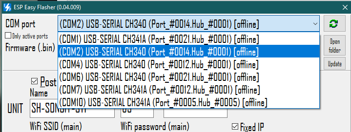

Another thing which has changed in the Dallas plugin is that we now allow to have a separate pin for input and one for output.
But the last one is optional as you can still use it with 1 pin perfectly fine.
However this was needed for some ESP modules (I think it was some Shelly unit) which has added some isolation to protect its users. However such isolation is only for 1 direction and thus you need a separate pin for reading and one for writing.
No idea why things will not be updated in that flash tool.
It just parses the files in its bin folder. But maybe this parsing is only done when the application is started?
If you have issues flashing, you may also want to try the Espressif Download tool, which is also included in the (massive) ZIP download.
See the documentation on this tool: https://espeasy.readthedocs.io/en/lates ... nload-tool
The screenshots are for flashing ESP32, but for ESP8266 it isn't much different.
Just keep the "offset" at 0, just like in the screenshots.
Don't flash the .bin.gz files, but just the .bin file for ESP8266.

With the FlashingTool I haven't any trouble. That works like a smart.
Meanwhile I have download by hand "ESPEasy_binaries.zip" (created at 17.DEC.22) and extract them into the /bin. Now I have the new filez available in the Flasher. I will try to update it inside the next hours and call back here then...

#48 Post by M*I*B » 22 Dec 2022, 16:23
:cry: :evil: :lol: :lol: :lol:
Ok... Looks like the port isn't broken after all...
If the flasher is on my NAS, it simply doesn't work! Only after I put the whole folder back on my C disk does something happen again.
The flasher obviously does not work if it is called via an SMB share (here: R:\Operating Systems\ESP Easy, SONOFF, WeMOS\). A second USB2SER connected in parallel via RX<-TX from the UART used for flashing shows that the flasher called by the SMB release is not sending any data in the direction of the ESP.
I just downloaded the current one (0.04.009). Compared to the 007, the 009 version has the problem that it does not recognize a single COM port as active; but still works...
DLzG
Micha

M*I*B
Posts: 379
Joined: 22 Jan 2018, 15:47
Re: re-entry and massive problems
#50 Post by M*I*B » 22 Dec 2022, 16:36
... I haven't checkout the other tool yet. I will do that the next days. Looks like that I have take much more attention about many things...
Some more to my former text...
It is not possible to use "program only". Every time I try I get an "COM port is already in use... Why is that?
EDIT:
I have downgrade the "ESP Easy Flasher" to .007 and now they find the active COM-ports... Just like to say ...
DLzG
