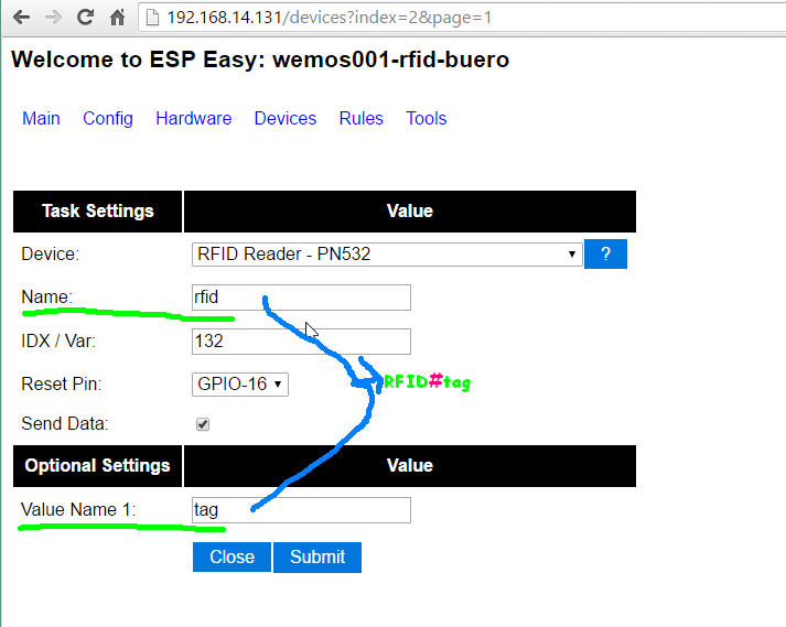

any chance to use something like this?
to compare PN532 tags?
on pn532#tag do
if [pn532#tag]="4034998235" // correct tag
gpio,15,1 //green led - ok
timerSet,1,1
gpio,13,1 //red led - stop
timerSet,1,1
on Rules#timer=1 do
gpio,15,0
gpio,13,0

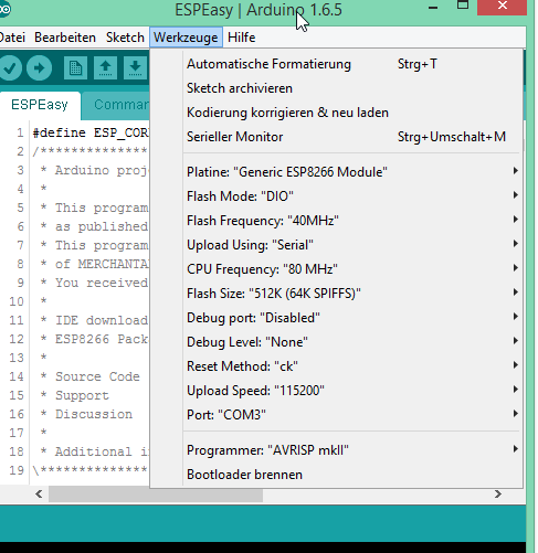

Re: Rules examples
Thank you tozett for the tutorial.
But, with all due respect, to go through the whole process of setting up the Arduino IDE and then getting all the files and things in place, is a route that I really would not like to take.
I think Martinez would have everything ready to go, and with one or two clicks could possibly have a "standard type" binary, like R78. It is to people like him that I would plead to get hold of a copy.
Re: Rules examples
i can do one binary like this, if you like:
give a (public) place to upload ...
- Zwischenablage06.png (32.34 KiB) Viewed 67351 times

did you tried this, if it works? (will build something similar myself..)grz3 wrote:any chance to use something like this?
on pn532#tag do if [pn532#tag]="4034998235" // correct tag gpio,15,1 //green led - ok timerSet,1,1 else gpio,13,1 //red led - stop timerSet,1,1 endif endon on Rules#timer=1 do gpio,15,0 gpio,13,0 endon
looks to me, if it is normal like other comparison...
Re: Rules examples
tried, but not working, the quotes are kind of problem I think..tozett wrote:did you tried this, if it works? (will build something similar myself..)grz3 wrote:any chance to use something like this?
Re: Rules examples
http://www.esp8266.nu/forum/viewtopic.p ... 1430#p6198
there is an working !! example of the same with IR-input.
another user stated this. may you try again without ""
if i find time this week, i will also try this...

Re: Rules examples
look here: ?
http://www.esp8266.nu/forum/viewtopic.p ... les+syntax
the wiki is something short in explanation of rules,
but it think this comes to
[devicename#valuename1]
you can control/debug this in the log of the ESPeasy...
- Zwischenablage02.png (35.51 KiB) Viewed 68524 times
