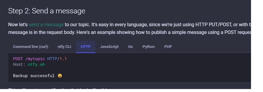

The example image shows a POST request, but not sure if we can do anything else than a GET using SendToHTTP from ESPEasy...

It seems, that GET requests are beeing redirected to https:
https://docs.ntfy.sh/config/#nginxapache2caddy
Bildschirmfoto 2023-01-02 um 14.02.43.png (18.53 KiB) Viewed 24673 times
Re: Integration with ntfy
#8 Post by Ath » 02 Jan 2023, 15:26
chromo23 wrote: 02 Jan 2023, 14:04 It seems, that GET requests are beeing redirected to https:
That's usually 'caused' by your browser, as they insist on using https, but the (external) website is most likely only HTTPS enabled (with redirect from HTTP), while the self-hosted software can be configured to accept HTTP ;)

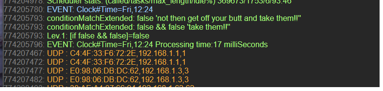

Still no workie. Nothing in the log except the standard "Event clock#time=bla bla
EDIT: Set the log level to debug and this shows up.
Log debug.png (24.79 KiB) Viewed 24169 times
#20 Post by Ath » 27 Jan 2023, 21:27
You might want to use "on Clock#Time=all,**:** do" to trigger every minute, if only for testing and looking at the logs
#21 Post by Ath » 27 Jan 2023, 21:30
Seeing that conditionMatchExtended log responding to the "if" in the message seems a bit weird, possibly related to a (bad) quoting issue
#25 Post by Ath » 27 Jan 2023, 21:51
Taking the "If" out of the message seems to fix it, that's surely something to investigate... :shock:

Ath wrote: 27 Jan 2023, 21:51 Taking the "If" out of the message seems to fix it, that's surely something to investigate... :shock:
You nailed it! Took the "if" out of the statement and it works.
Time to start investigating..... :lol: :lol:
#27 Post by Ath » 27 Jan 2023, 22:35
I've created a pull request #4486 to fix this issue. Would have been the same for "elseif " but that's much less likely to be used in any text, other than code :lol:
