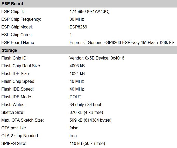

Can you also check on the sysinfo page what flash size is detected?

#5 Post by HenrysCat » 15 Mar 2023, 16:56
This part?
Posts: 9901
Re: Unable to flash 4M1M to D1 mini
#6 Post by TD-er » 15 Mar 2023, 17:05
Yep and exactly what I wanted to know :)
The flash brand isn't PUYA (unless they now use a different vendor ID) and it is indeed 4M flash.
The "PUYA patch" isn't present in 4M builds, as there have not yet been flash chips > 1M which act as strange as PUYA does.
So that could have been one of the reasons why a 4M build might not have worked, but an 1M build does.
So I totally agree with Ton's suggestion to wipe the flash completely using a "blank" image of 4M and then write a 4M build to it.

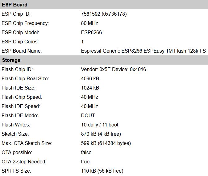

Tried the blank image then the 4M no access point again, reflashed 1M all good, tried a NodeMCU I have also, exactly the same, blank 4M image > 4M, nothing > 1M all good.
NodeMCU below.

And preferrably on a (better) powered USB port, like a powered USB hub or USB3 port (those can deliver upto 900 mA)
Some units sold as "Wemos D1 mini" have really poor quality voltage regulators, which may just not be able to handle the current draw required by the WiFi.
On 1M builds there is some extra delay before starting WiFi, because quite a lot 1M nodes like Sonoff Basic have really poor power supply designs.
HenrysCat
Posts: 7
Joined: 15 Mar 2023, 12:40
#13 Post by HenrysCat » 16 Mar 2023, 18:58
Yes that works, I plugged it in to my Anker 60W PowerPort and it showed the access point with 4M flash, once it's conected to home WiFi I can then plug back in to the PC USB port and it works fine, guess it just needs the extra power to create an access point.
Thanks fo your help :)
Posts: 9901
#14 Post by TD-er » 16 Mar 2023, 20:37
You can enable the "ECO" mode on the tools->Advanced page to reduce the load on the voltage regulator.
