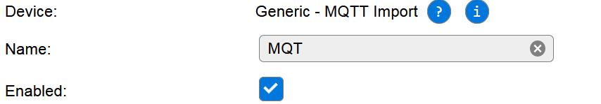

The checkbox for the "MQTT Import" plugin turns off on its own!
This checkbox turns itself off! This happened for the second time in a month. Now I flashed the latest firmware (ESP_Easy_mega_20230306_collection_A_ESP32_4M316k.bin). I will watch further.
Andy.
Re: The checkbox for the "MQTT Import" plugin turns off on its own!
Those will be turned off when you have had several crashes in a row.
ESPEasy will then detect it hasn't completed a full boot and after 10 of such it will 1-by-1 turn off tasks until it can complete a boot.
N.B. those will only be turned off in memory and not saved.
However, if you then save the settings with the task disabled, it will save this disabled state.
If you then just turned on the task again via the "taskenable" command and never saved it, the task will be disabled after a reboot.
Ohh...
I don't know what to do, put the TaskEnable in rules.
