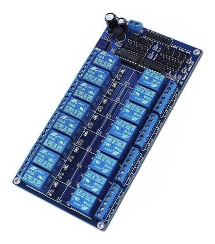

Hello how are you? I am modernizing my house little by little, now I have a 4ch relay module working + mcu8266 module + esp easy firmware + inventor app, everything works perfectly from my local network from the browser or with my cell phone, what I want now is to use a relay module 16 relay and be able to control them with 16 switch buttons as input using the mcp23017 module that communicates with 2 GPIO of the mcu8266. Now I am controlling the 16ch relay module using the pca9685 module as output and I manage to control it perfectly through the web browser, but I do not understand how to use and connect the mcp23017 module as input of the 16 switch buttons, first of all I want to tell you that I am a beginner and I don't know anything about programming rules in esp easy, if you can help me with the steps to follow with the procedure to be able to turn a relay off or on with the switch button using the mcp23017 module, I would appreciate it
I leave an image of the relay module

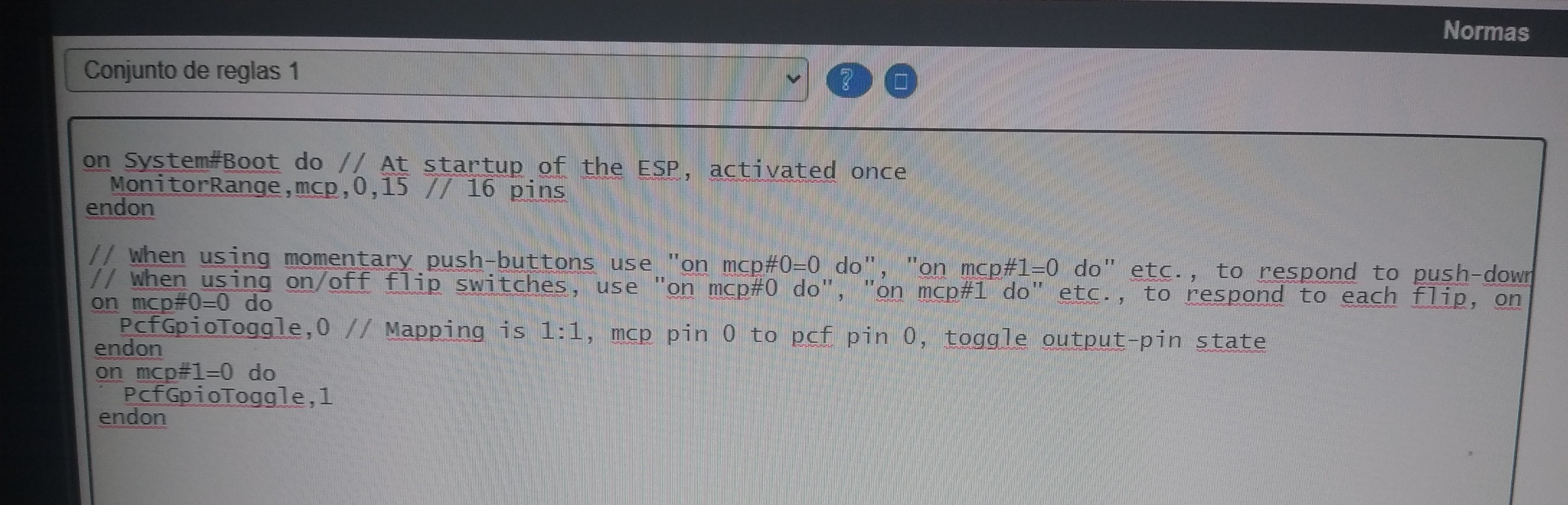

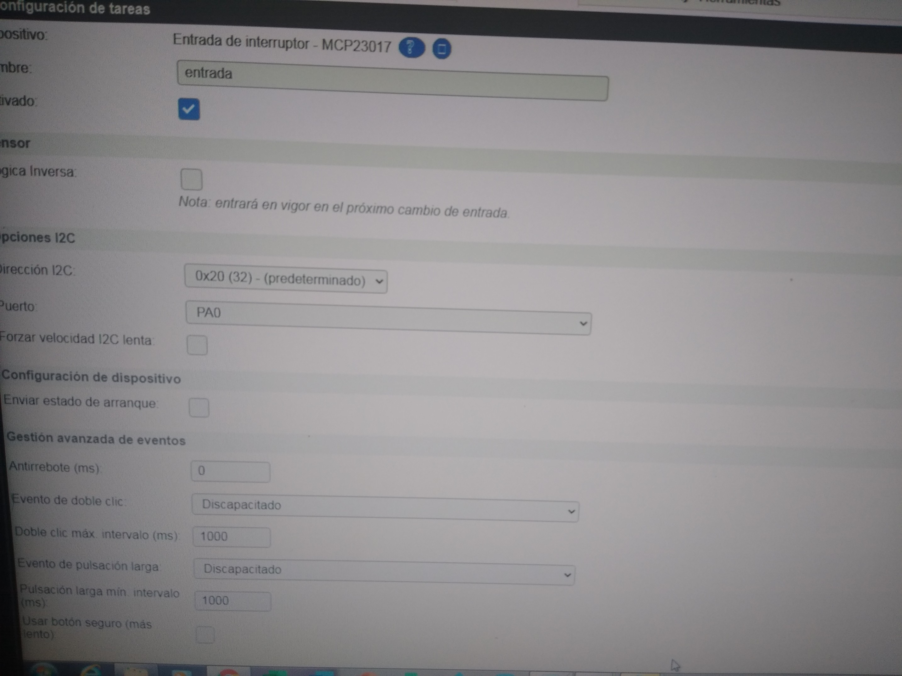

Hello friends how are you? I was trying the instructions they gave me, but the mcp23017 module is not working, only the pca9685 module works, which when sending the browser example 192.168.0.5/control?cmd=pcapwm,15,4095 or 192.168.0.5/control?cmd=pcapwm ,15,0 The control of the relay works perfectly, but when I want to control it manually by sending GND to one of the pins of the mcp23017 module, it does nothing at all in the relay, I only observe data that enters the esp easy, but it does not make any changes mechanical in the 4ch relay module. I ask you to look at the photos that I leave so that you can analyze how I connect it and the esp easy data.
questions
1 in esp easy is the mcp23017 correctly configured? I leave the photo.
2 in the rules part, I leave the photo, is the code they gave me correct? Do I have to put all the complete code? or just a part of said code? I clarify that I want to use switch buttons that when pressed the relay is activated, and when pressed again, the same relay is deactivated, so with the 16 switch buttons with the 16 relay module that I plan to use.

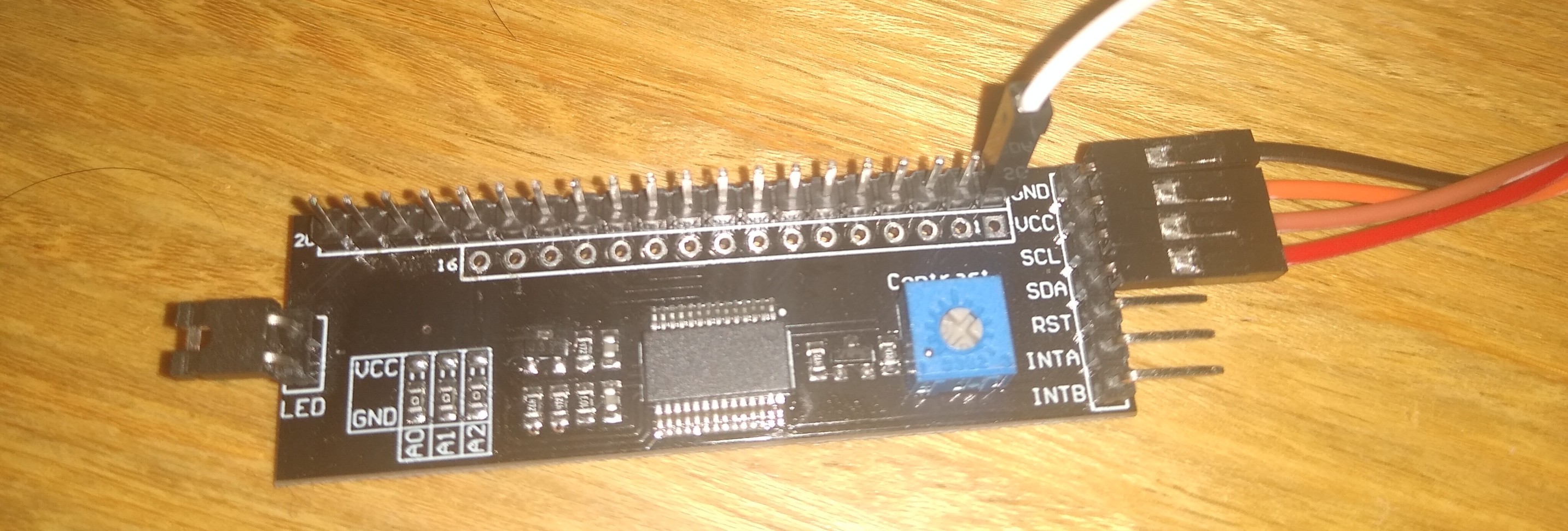

3 that module that I bought, is the mcp23017 the correct one? because they say that it is for LCD display, but that it also works for this purpose, only the VCC, GND, SCL and SDA pins are connected in parallel.
Thank you very much from Argentina.
mcp23017 module with the white cable that is GND to test the different pins of the chiche module

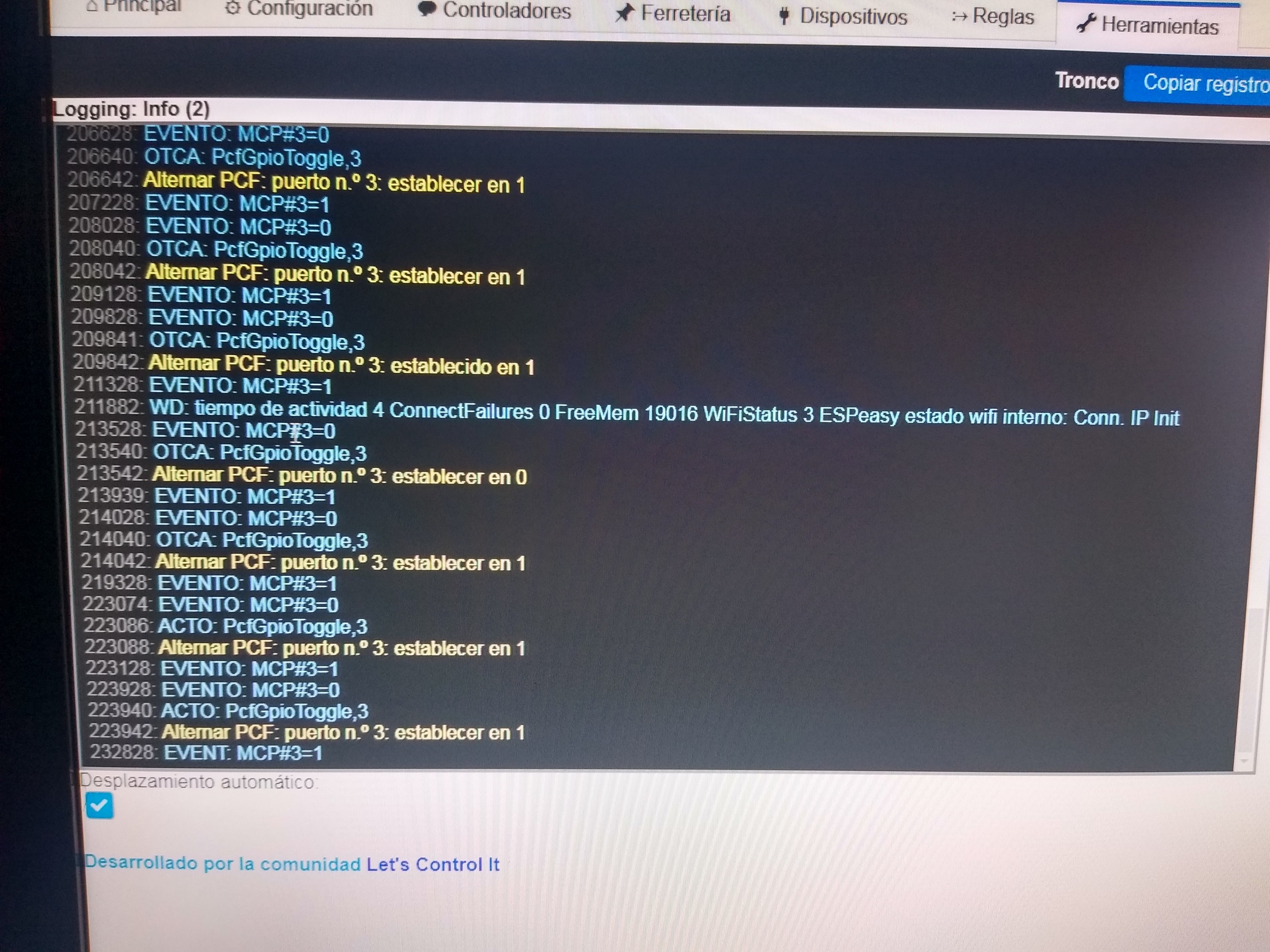

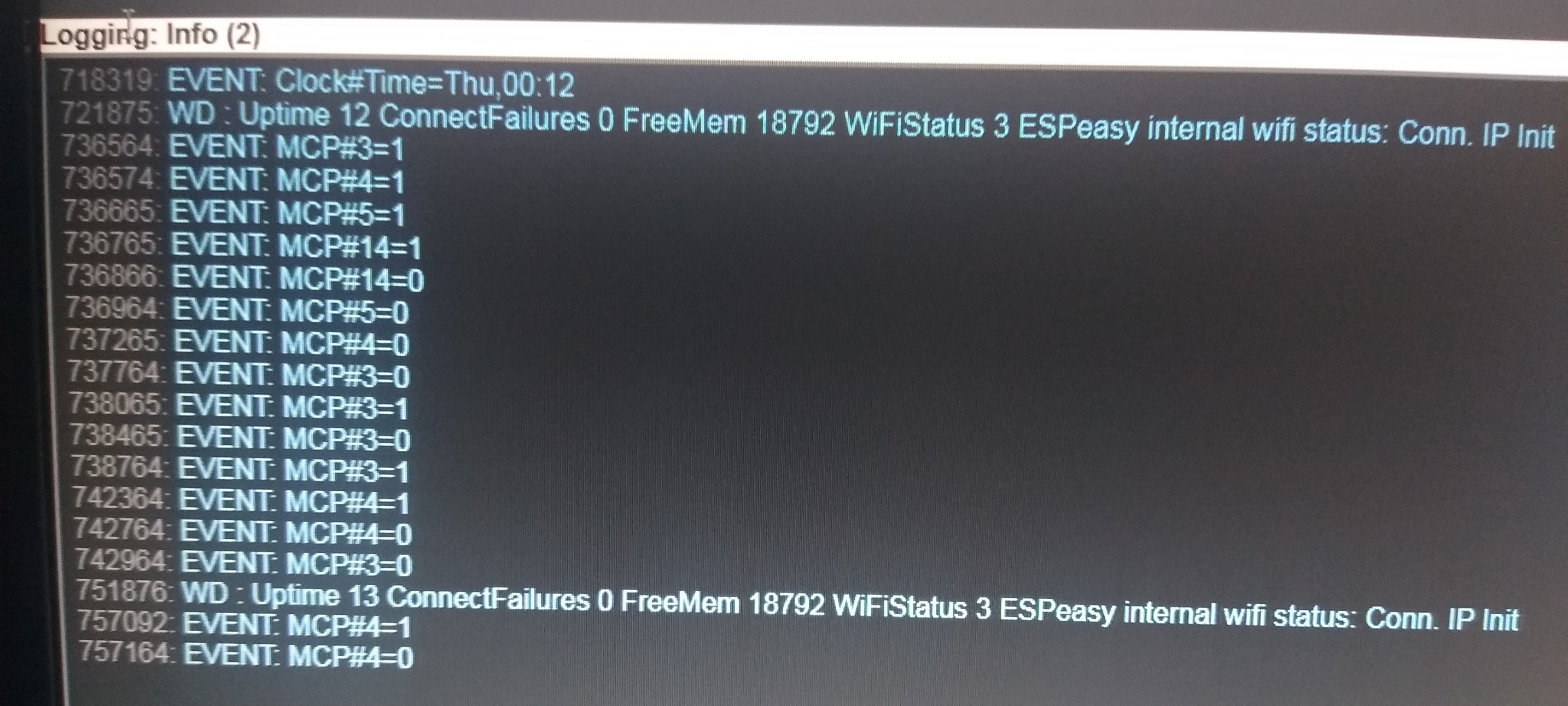

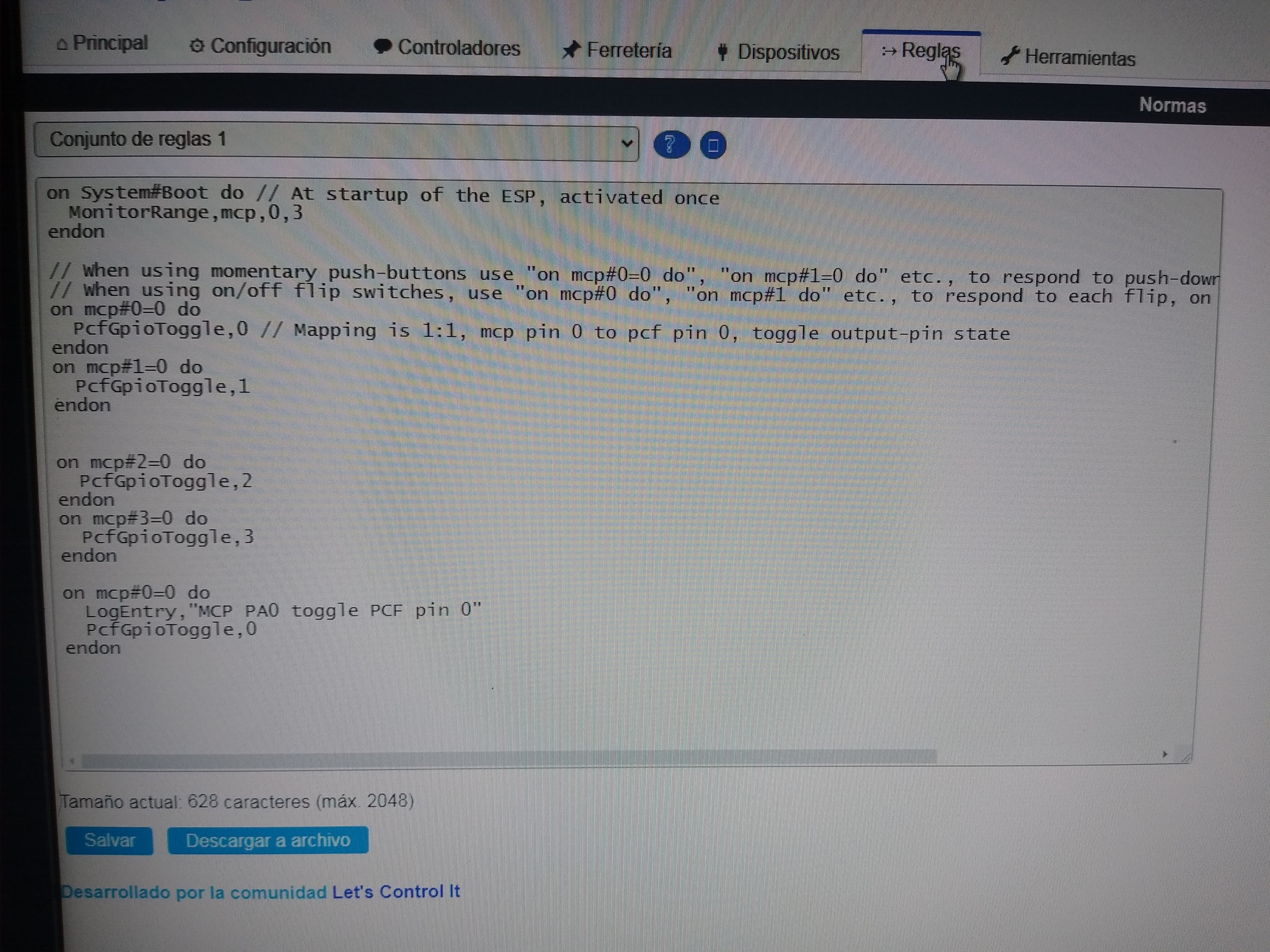

hello, how are you, I was adding the code you sent me, but it still doesn't change the relays, I sent GND to all the pins of the mcp23017, but it doesn't do anything at all, there is only activity in the esp easy of the events, I'm going tomorrow to add the resistors that you told me, I have to add the resistors to each pin of the mcp23017 to GND???.
I'm sending you a photo of the code, correct me if it's correct since I'm very lost in programming, I'm an apprentice.
thanks my friend.

#10 Post by Ath » 29 Mar 2022, 07:47
1)
Looking at the log I would say it is working as intended. If the relays are not responding to the changed state, then I'm interested to know if they change state if you manually (on the Tools page) submit this command: pcfgpiotoggle,3
If then the relay state doesn't change you have a wiring issue on the PCF side.
2)
You now have twice the event handler "on mcp#0=0 do" in your code. My intent was that *only* the "LogEntry" line was to be added to the existing "on mcp#0=0 do" event handler. By having it twice, it will be executed twice, so the end-result will be the relay keeps the same state...
3)
a) Would it be possible to not translate the log entries?, as for non-Spanish speaking people, that's quite confusing to read. And the text can't be selected/copy-pasted into a translator
b) Instead of screen-photo's, can you use the screen-shot functions available in Windows, or just copy/paste the logs into a [ code ] block in the forum, to share your information, if only for better readability

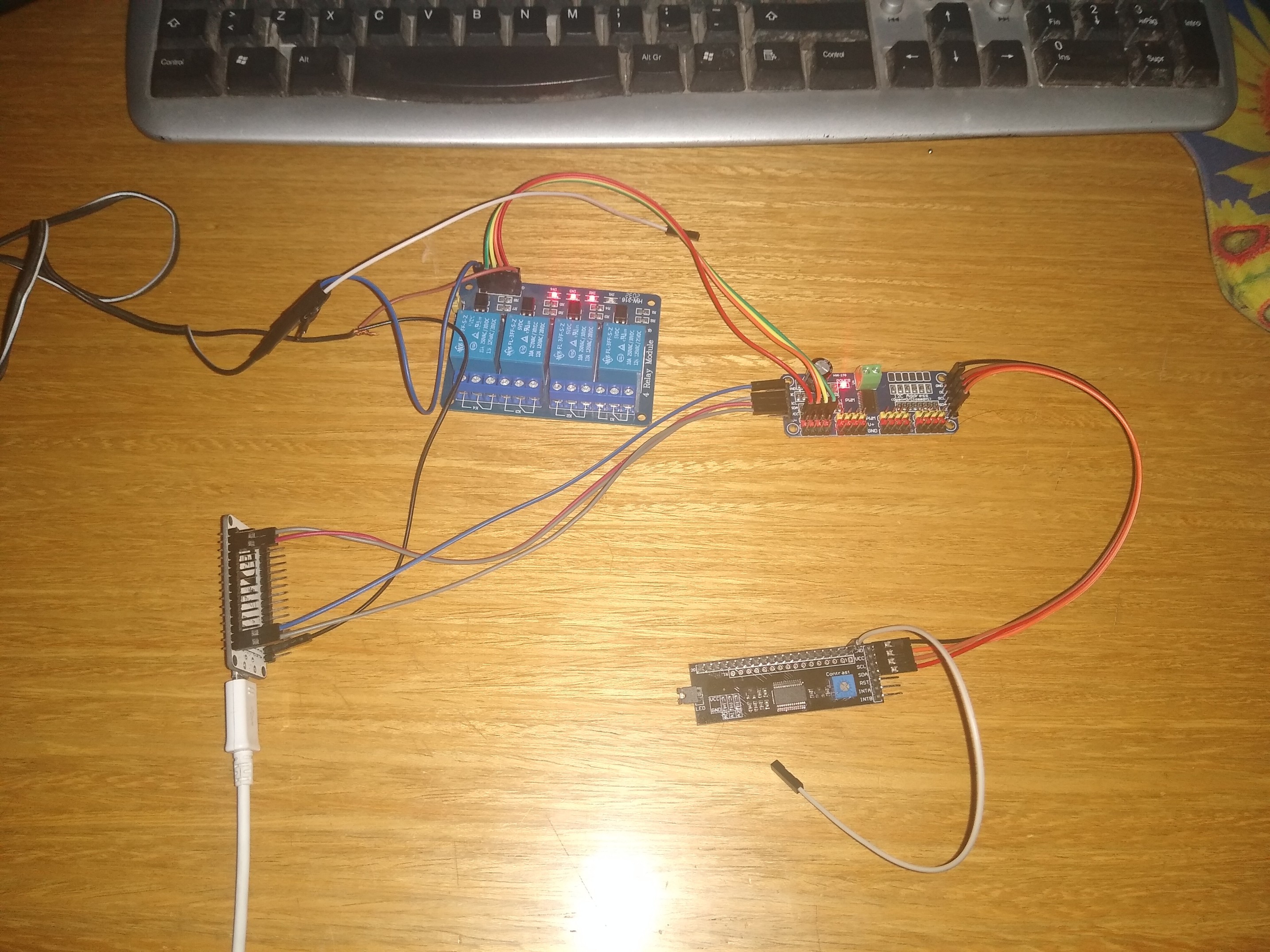

the physical electrical connections are as follows on the pca9685-mcp23017 board and the mcu8266; the SCL and the SDA are in parallel in the mcp and the pca.
after the mcu8266 SDA: GPIO-4 (D2)
SCL: GPIO-5 (D1) to pca9685 board.
pca and mcp are powered by the mcu8266 with the 3.3v and GND in common on the 3 boards and also with the 4ch relay module.

That looks as it should, but still, the relay isn't working. Have you tried to toggle pin 2 instead of 3? (as you are using pcapwm,2,4095 below)
esptita wrote: 30 Mar 2022, 06:13 However, when I enter the command in the google browser in the address bar, the following is taken; http://192.168.0.104/control?cmd=pcapwm,2,4095 the relay works perfectly.
then something is wrong that prevents the pca from communicating with the mcp.
I don't understand why you use a pcapwm command to "switch on" a pin, that should normally be a pcfgpio or pcfgpiotoggle, I think, for switching on/off a pin.
esptita wrote: 30 Mar 2022, 06:13 the physical electrical connections are as follows on the pca9685-mcp23017 board and the mcu8266; the SCL and the SDA are in parallel in the mcp and the pca.
The problem is in the connection to the relays, not in connecting the boards to the ESP.

3 the physical electrical connections of the 4 modules is as follows:
1 of the mcu8266 using D1 and D2, to the SCL and SDA input of the PCA, and in parallel the same pins to the input of the MCP and the 4ch relay module connected to the output pins of the PCA9685. There are photos that I uploaded that show the 4 modules connected.
4 I already ordered the PCF8574 module and I am going to replace it with the MCP that maybe is defective, I don't know.
